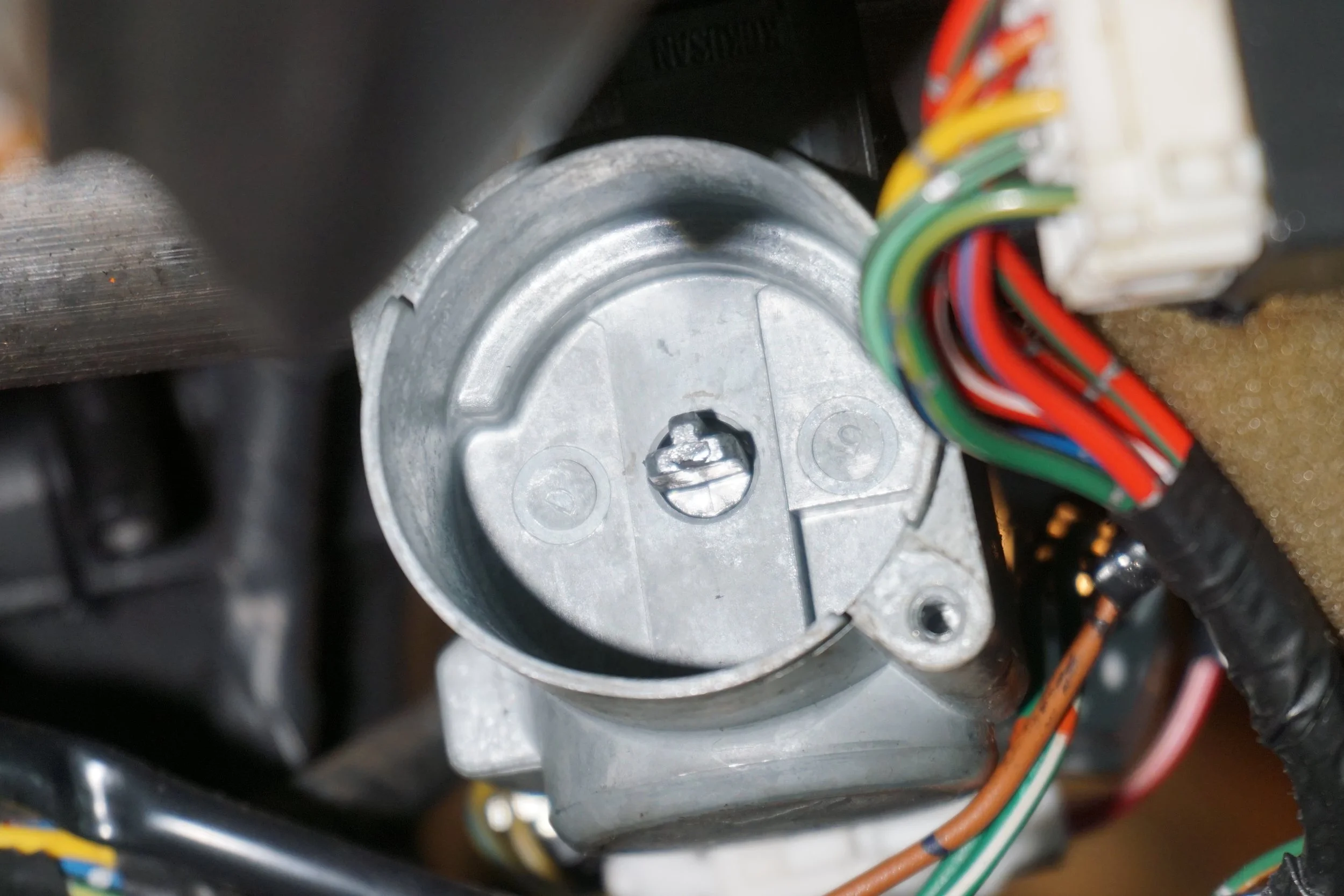

This is my description of the "slop" cause of a no-start no-crank condition. I'm putting it here to get it all in one place, so I have an easy thread to link back to.
The symptoms: You turn the key and the starter doesn't turn over, but the dash lights all go on. (If the dash lights don't go on, you probably aren't getting power to the ignition switch, so you should look somewhere else.) I found that if I turned the key enough times, usually I could get it to start. But sometimes it took 10 or 15 tries.
The problem: If you replace your ignition switch, you'll see that it has a T-shaped slot in the face. (Here's a good how-to on replacing your ignition switch:
It's a pretty simple process.) If you look inside the steering column, you'll see a corresponding T-shaped piece of metal. When you turn the key, the metal piece turns the ignition switch and the starter wire gets juice. But over time, a little slop develops between the piece in the key cylinder and the slot in the switch, and the switch won't quiiiiiite turn all the way to engage the starter.
This isn't going to be the case every time you have a no-start no-crank condition. It may well be that your starter is bad or your battery isn't sufficiently charged. This assumes you've already ruled those out as causes. You can check for the problem by taking the ignition switch out of the column (keeping it connected) and using a screwdriver in the slot to start the car. If it starts every time, you probably have the slop problem. However, since the problem is usually intermittent, it may take you a while to decide that it really does start every time with the screwdriver. In the meantime, you've made it ridiculously easy for your friendly neighborhood car thief. And you don't want to use the screwdriver too many times or you may deform the slot. If you have the ignition switch out in the first place, you might as well fix it and put it back in.
The obvious fix, and the one a dealer would no doubt insist on, is to replace the key cylinder. You can do that, but it's a bit of a PITA the first time you do it, and an unnecessary expense. The alternative is just to shim up the slot in the ignition switch to eliminate the slop.
I first tried a piece of electrical tape down in the side of the slot. Here's what that looked like. http://s397.photobucket.com/user/Dbe...ion-1.jpg.html (The circled piece is electrical tape, even though it looks gray.) That worked fine for a while, but eventually the tape worked its way out, probably after a number of hot days. Others have used multiple pieces of duck tape, which might hold longer. But I finally ended up cutting a little piece of coke can to a shape that will fit in the side of the slot, and then super gluing it in. (The shim goes into the side of the slot, not the bottom.) If you look at how I put the tape in, you should get the idea. So far that's worked beautifully.
Incidentally, this isn't a matter of a bad ignition switch. When it first happened, I replaced my ignition switch with a new OEM, and it didn't help. The problem is a result of the piece in the cylinder lock not pushing the ignition switch far enough over to engage the starter. If that's what's happening, a new ignition switch is unlikely to make a difference.

I fixed it by folding a business card in half about twice, then cutting it the exact size of the slot in the ignition switch and shoving it in there. It actually worked really well. I did it this way after the electrical tape thing failed.

This is a very helpful post. I'm having these exact issues with my 1997 Nissan Maxima GLE right now. I was thinking about just replacing the ignition switch, but it sounds like that might not fully solve the problem. My question is about the shim. Where exactly does the shim go? I clicked on the link to the photo, but the photo is no longer available. I would appreciate it if you could post the photo again, or give a detailed description of where to put to put the shim. Thank you in advance to anyone who can provide this additional information!
Old Mar 13, 2024 | 08:52 AM
shanzo's Avatar
Joined: Feb 2024
I'm bumping this in hopes of a reply. I need to know specifically where the shim goes. There was a link to a photo, but that link no longer works. Does the shim go inside the walls of the female portion of the ignition switch? Or does it just get inserted somehow in between the ignition switch and the lock cylinder when you screw the ignition switch back on? Any assistance would be appreciated. This problem continues to get worse for me, and for some reason, it is even worse when the car or the weather is warm. I'd like to get this fixed before it starts to get hotter outside. Thank you!

If I recall correctly, I just wrapped the male side with a piece of aluminum sheet cut from a soda can, then insert it into the female switch assembly.

I had the same problem recently and changed out the ignition switch which seemed to help for a while, but the problem eventually came back. I did the aluminum slice slop fix next and that seemed to fix the problem for a while until it came back worse than ever. When it didn't start, all the dash lights would come on and I could hear a click every time I tried to start it. Eventually it did start and was strong and normal, so that pointed me to look at the starter relay. When I inspected the relay box I found that the wiper relay was exactly the same as the starter relay, so I swapped them, and so far it has started on the first try every time since I swapped them. I’m hoping this fixes it for good and will report back if it doesn’t.
Old Apr 24, 2024 | 04:45 PM
shanzo's Avatar
Joined: Feb 2024
I thought I would report back my results to this community as an additional reference point. My symptom was that my 97 Maxima GLE occasionally wouldn't start or make any clicking noises when I turned the key, but the dashboard lights would come on. It seemed like the problem was a little bit worse when my engine was warm or when it was warm outside. Eventually, it would always start if I turned the key enough times. The problem was getting worse.
Here is what I tried:
1. Added a shim to the ignition switch - Didn't solve the problem
2. Completely replaced the ignition switch - Didn't solve the problem
3. Replaced starter - Fixed the problem immediately
Hope this information is helpful.

So for the people who successfully fixed the slop, at which position did you put the slice of aluminum?
Did you slide it around the outside of the T shaped pin so it didn't have so much wiggle room in all directions, or did you actually put it on the T shaped piece itself?
Old Jun 17, 2024 | 01:01 PM
Zerodrag's Avatar
Joined: Mar 2003
Posts: 221
From: SoCA
I believe I wrapped/shaped it around the t-protrusion.

I spent some time with this and was able to fix my problem! I cut a slice from an aluminum can and made a few shims. One shim I wrapped around the T shaped rod coming from the key cylinder, as I was able to wiggle it around quite a bit. This helped, but didn't completely solve the problem. I then inserted a shim into the ignition switch itself, and now the problem has truly been solved. The key feels a lot tighter now when I turn it, and the car starts "stronger" than it did before. After more than a week of testing, I'm calling this very annoying problem solved.
I made a video in case anyone wants a better idea of what you need to do.
