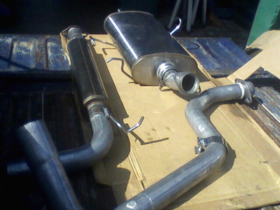

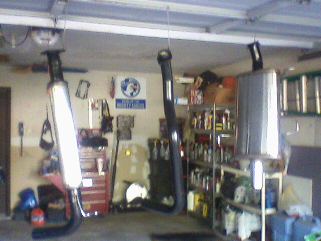

MES system:
Not broke in yet!

Originally Posted by CMax03
MES system:
Not broke in yet!
MES 4th Gen Catback - YouTube
IMO, that MES system sounds like crap and I"m not too thrilled about those flanges either.
That video of mine if that's what you're referring to sounding like crap was only about 5 miles into operation......As the exhaust fills with soot/exhaust deposits it mellows down quite a bit and softs any raspiness that exist.....My mufflers are huge both resonator and rear main and the idle now it nearly not audible....The sound is mellow and smooth.....and everyone does have thier personal exhaust hole and an opinion!

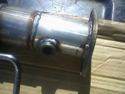

What about the flanges???? The rear flange is a gasketless ball socket design...(OEMs still use the hell out of!!!!) easy to adjust any angles needed when positioning your exhaust system......The front is your typical welded on 2 bolt flange using OEM SS gaskets, Copper gaskets or the El Cheapo fiberbased gaskets.....So what's your hang up Wizard???
What about the flanges???? The rear flange is a gasketless ball socket design...(OEMs still use the hell out of!!!!) easy to adjust any angles needed when positioning your exhaust system......?
I don't like this style. Seen too many over the years develop exhaust leaks. I much prefer the typical flange to flange setups with a gasket, or v-band setups. To each their own.

Why even post a video of a system that's not broken in in the first place? Worthless.
I was in a hurry to post the exhaust video due to Orgers wanting a video ASAP and the system had no mileage yet! So that's how & why that happened....I've got those ball/socket joints on my 3rd Gen headers and they're leak free and gasket free....Thanks for your response I value your opinion Wizard.

I know this thread is a bit old, but I was hoping to get a few more details on CMax's setup.
CMax, is that the optional resonator from MES? If so, is it the 14" or 18". Also, which muffler is that? Finally, what paint did you use for the coating?
Thanks!
Thanks!
MES option are 14" or 18"....I choose neither! I believe the bigger the better whan talking about mufflers...I choose Magnaflow p/n: 10436 and for rear mufler a 5" x 11" Magnaflow p/n: 12576. Forgot one thing the paint is regular high temp duplicolor engine paint (1200*F) I've tested on headers and it doesn't flake off at all if properly installed!!!!!!!! My test was for 6 months and my headers never flaked at all!!!!! Get this from your local auto parts store!
http://www.magnaflow.com/02product/s...=main&id=11355
http://www.magnaflow.com/02product/s...=main&id=11439

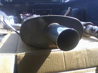

I haven't made any videos since it's been broken in....But I will....It's pretty freakin quiet definitely compared to the Flowmaster only exhaust system it come with! The Ypipe is a Warpspeed Ypipe....I'll probably put some EBAY headers on this just to see how they fit and perform.....I'm sure they'll outperform the Warpspeed ypipe! I have a 2.5" Metallic Substrate Cat on my 5.5th Gen that will be upgraded to a 3" Metallic Substrate...I'm running my 5.5th OEM Cat currently on my 4th gen.....
I'll look forward to any new videos! What tip did you use?
Old Feb 20, 2014 | 09:56 PM
CMax03's Avatar
Posts: 9,587
From: Houston, Tx
A dual wall SS piece, forgot what brand....
