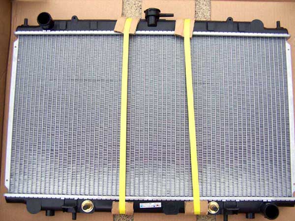

The breather hose for the transmission is a good question. I also wonder if the oil cooler line that runs through the bottom tank of the radiator is plugged up.

Can u post a pic of what ur talking about so I can check? Wouldn't I have had an issue way before a month passed tho?

The radiator has an oil cooler built into it. It is in the bottom tank, below the cooling fins. You have to connect 2 lines from the transmission to the radiator.
Below is a photo of a new radiator before I installed it in my car. The photo is looking at the side that goes towards the engine. In the top left corner of the photo is where the upper radiator hose attaches. The bottom of the radiator, the black part below the silver cooling fins, is the lower tank. To the left and right of the yellow straps are the transmission oil line inlet and outlet connectors. You should have lines from the transmission connected to these.
If the transmission was running too hot and self destructed because of it, I don't know how long it would take. I doubt if anyone could predict it. But for oil to come out the dipstick, the transmission is being pressurized. I'm taking a guess at boiling oil.

yeah, there's 2 s-shaped lines that connect underneath the radiator to the trans that can cause major problems if leaking but you would see fluid blowing all over the place if they weren't present. i had 1 of the lines leaking and replaced it cause my trans felt weird like it was'nt shifting at the proper shift points ( auto ) and topped off the fluid and turned out i needed a new trans anyway. my new trans had 90,000 miles on it when installed and seems good so far.
