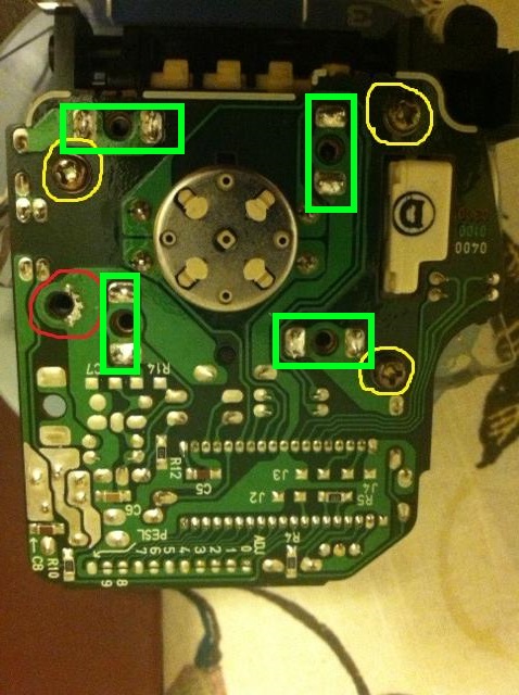

I have been having problems with my cruise control working intermittently and I have a VSS error code. After doing some research, I have determined that I need to resolder my speedometer PCB board. I have seen others stress that the the hole circled in red needs be be soldered but what about the other holes circled in yellow?

The contacts marked with a green box are what needs to be resoldered.

Thanks for posting the circuit board with re-solder locations.

After resoldering the contacts marked with a green box and red circle my CC is now working.
