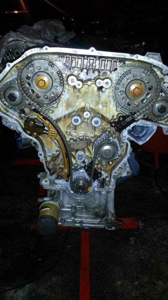

I have a 1995 maxima I am changing the timing chains due to noise and I thought it jumped timing plus oil leaks. During removal I had the engine at tdc, crank pully lined up, can lobes on cyl 1&4 in the right positions. The chain had a ton of slack in it and the chain chain links on the main chain were in the wrong location but mechanically the engine is timed correct. Will just putting on the new chain with no slack correct anything? Can sensor OK,crank sensors Ok. The original issue was when I cranked it one cold morning I got chain noise then a stumble and it shut off. Would not start.

Here's how it should look when you set your timing

I only had one colored chain link on all three chains. The gold link on the main chain never lined up with the notch on the crank gear. I set it to TDC many times,it never lined up. I had mm no dark colored links, not even on the secondary chains. I had timing chain noise, I started it and it went to start as usual, as soon as I heard the chain it sort of made a shutter or jerk and shut off. Would not start, spun over easy like if u had a timing belt break and every now and then try to fire.

The colored links are for assembly only. It will take many, many revolutions to line up again. At the very least it will take as many revolutions as there are links in the big chain.
