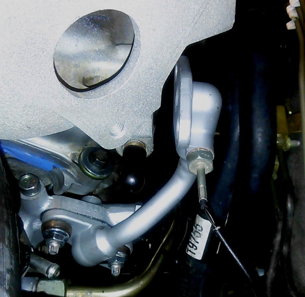

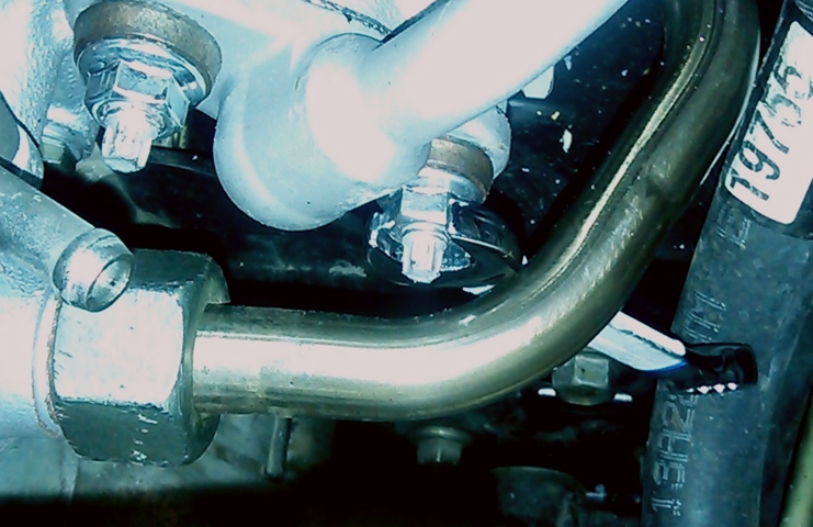

I've been using Felpro brand gaskets for years. The last set I purchased came with a small tube of RTV for the corners of the VC gasket. Follow the FSM for RTV use.
You can see the Knock Sensor in the picture above. I use a 1/4 inch drive socket with a 10" extension and a 1/4 inch drive U (wobble) joint to reach under the intake manifold to remove the KS bolt. I got someone with small hands to reach under the intake to reinstall the KS bolt.
I like to soak the EGR tube in carb cleaner to remove carbon deposits.

Like many on here, I bypassed the intake plenum coolant line U-shaped hose. I've also used a longer hose as suggested earlier in this thread by The Walkinator.
