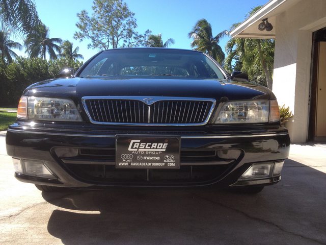

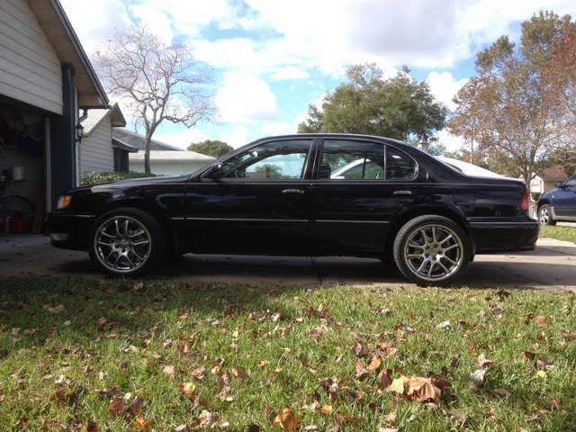

I was the lucky recipient of the '98 I30 with 51k a few months ago, and figured I give a little update and ask for a suspension recommendation. Driven the car about 5k now and only had one hiccup (Evap canister and control valve) replaced from pull a part for $20. Car was in Ohio the majority of its life and has some surface rust underneath, so a nice used southern part did the trick (although has a popping on startup, if anyone has an idea of what's causing it? pressure in the system?) trying to post a video of the sound. will below when i find it

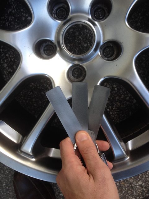

Getting these 18" sport wheels off myG35 powedercoated this week and putting them on the I30, which leads me to the suspension part. When I had them on my 96 I30 the wheel gap was horrendous. Now, I am not a stance person, nor will I be racing, but do not want a 6" gap either.
My two thoughts are something like H&R/illuminas or coilovers. Where I am torn is whether or not to do all bushings/A-arms/tie rods, etc while I am in there. Yes, the car is super low mileage and doesnt really need any of them done now, but I fear after sitting on the factory bushings/arms for so long + surface rust, etc and then being lowered may speed up wear. So what does everyone recommend? Trying to stay under 1k, and do a majority myself without a lift or airtools - so easier the better.
Lastly, here are some updated pics and a few oldies I found

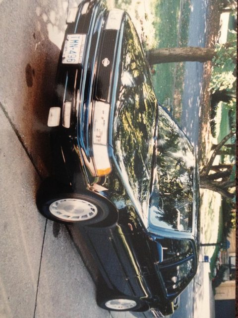

Bro's 1993 (in 1994)

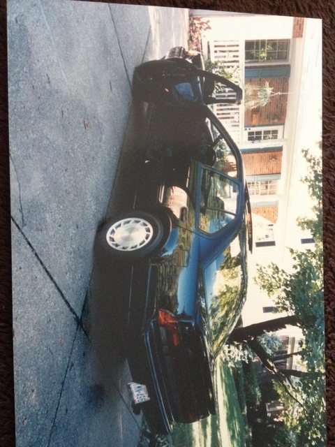

Current black Max's - 05/98

Since you wanted to see the difference between a stock suspension and H & R lowering springs, I found a couple of pictures to share.
1) Here's a picture with new KYB AGX struts on stock springs. You can see the orange KYBs showing above the front wheel.
2) Here's a picture with H & R lowering springs. It is not as low as it could be with coilovers -- but lower than stock.

This is my car with H&Rs, KYB-GR2s, and OEM 16s from a 2001 I30;
