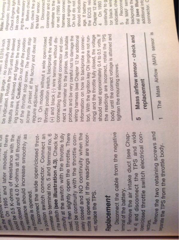

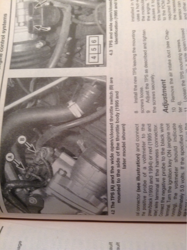

I did a lottle searching on google....from what I've found with your symotons...it points to a bad throttle position sensor...I'm pretty sure there is a way to check it with a meter, but not sure what the readings are supposed to be at as far as at idle and wide open throttle...start there and see what comes of it...the tps isn't a cheap part...I'm sure the wizard or Dennismik can chime in on this one

Hope these help...
January 30th-2016 and need help.  Any Advice-image-981448006.jpg January 30th-2016 and need help.  Any Advice-image-2045034339.jpg January 30th-2016 and need help.  Any Advice-image-3370230832.jpg January 30th-2016 and need help.  Any Advice-image-3762628287.jpg
