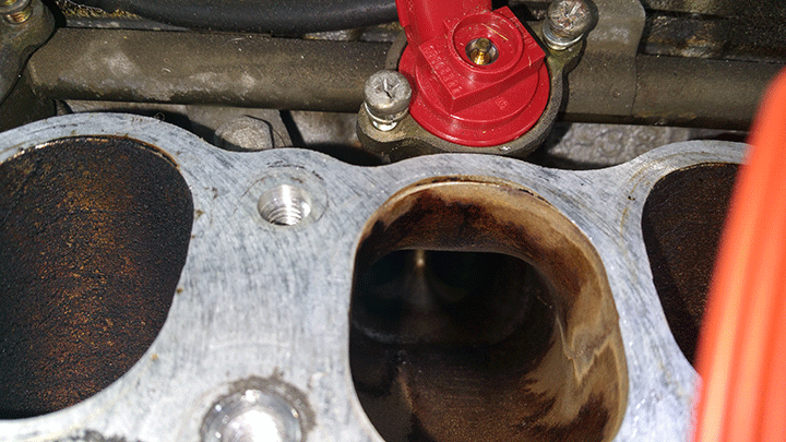

Ok so while checking my knock sensor as suggested from a previous post. I found something fury in that area where the knock sensor is, see pic. I thought maybe a squirrel because I saw a few acorns in there as well which I cannot reach. But it looks like just a ball of fur, wth is this crap. Oh yeah and the knock sensor has no crack in it either so no need to change it
Now to a few other items..

Mouse nest?
Do you see any chewed up wires? Roberts like to munch them.

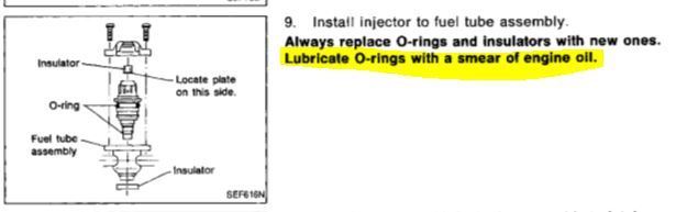

I had my injectors serviced by Injector Rx. They came with new o rings. The instructions said to lube them with motor oil.
I use some kind of lubricant every time I install an o ring.
Rubber parts tend to rip and leak if shoved in there.
But not if lubed.
Possible that you ripped or deformed the o ring.
If you remove the plugs, you might find a wet one.

I did lube the injectors before inserting, and was very careful that I applied even pressure and had them centered perfectly. They popped right in. I used some assembly lube (oil).
hmmmmm, I didn't so that when installing mine. Never even crossed my mind until today when I was re-tracing my steps. I also checked the service manual and it says to lube it with motor oil. &^#$#@

We all have learned from our mistakes. Part of the curriculum of the school of hard knocks...... and bruised fingers.
Bet you'll lube next time. ......
Yes, check or replace messed up o rings.
Details details.
This task is a true cluster cluck.
And a pita to go in there again.
Now you know why I said to do it all while you are in there.
Anything else you might replace some day? Do it now.
Don't want to do this a third time.
Hang in there. Good work.... the car ran.

So I ended up going to Nissan and buying 1 small O-ring all they had, and 3 larger ones. Went to Parts Authority and bought 2 kits and a GB injector just in case. I pulled the car apart in like 35-40 mins, getting good at this.
I pulled nmbr 3 injector and the ring was smashed, ripped and inflated... totally destroyed. So I pulled out the other 2 and same thing but not has bad.
Changed the rings but noticed the the piece above the oring was crushed too, so I ended up replacing that entire injector with the GB. Put the car back together and no more smoke and she seems to be running a little better. But still having an issue with the car idling at 200-300 rpms. Stalls a few times and takes forever to start. Just cranks and cranks. ughhh. but when she does start, idles at like 800 when cold, and then goes to 200-300.

Some pics of the busted injector o-rings and check out the cylinder walls of #3. Pretty clean, nice....but it scares me a little.
