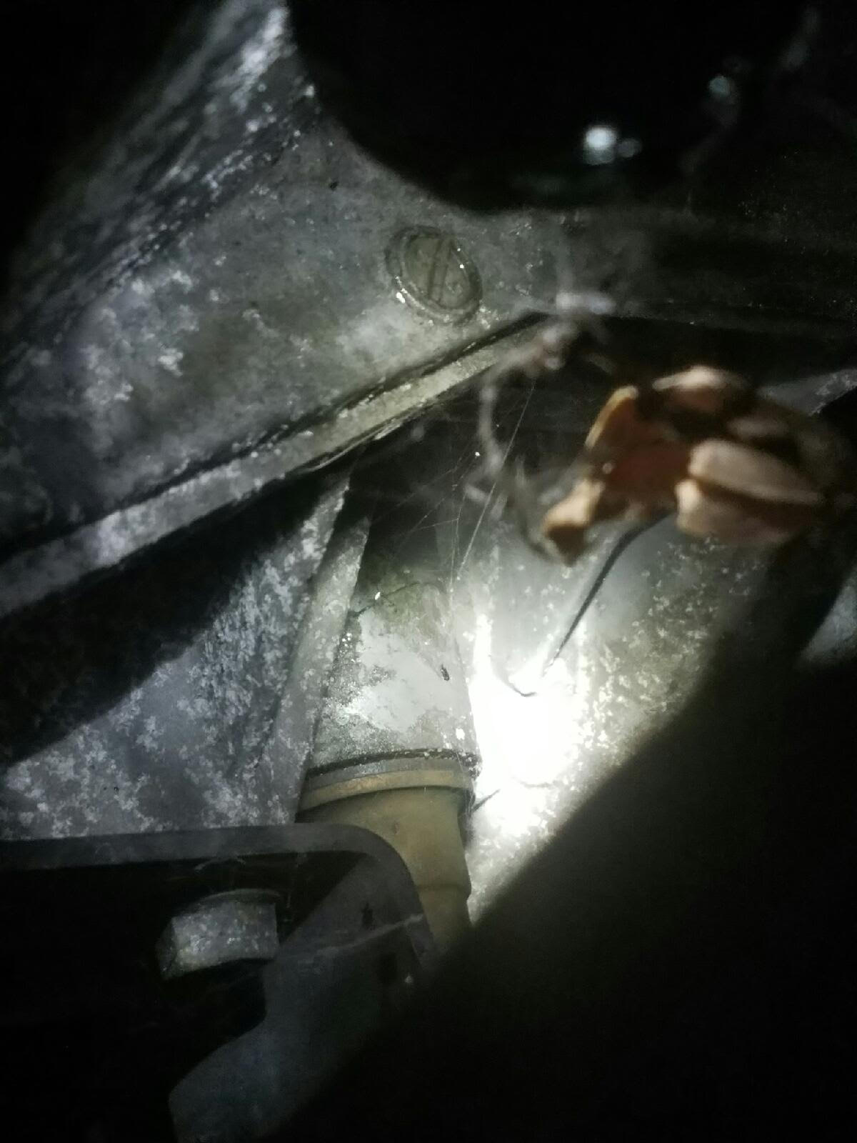

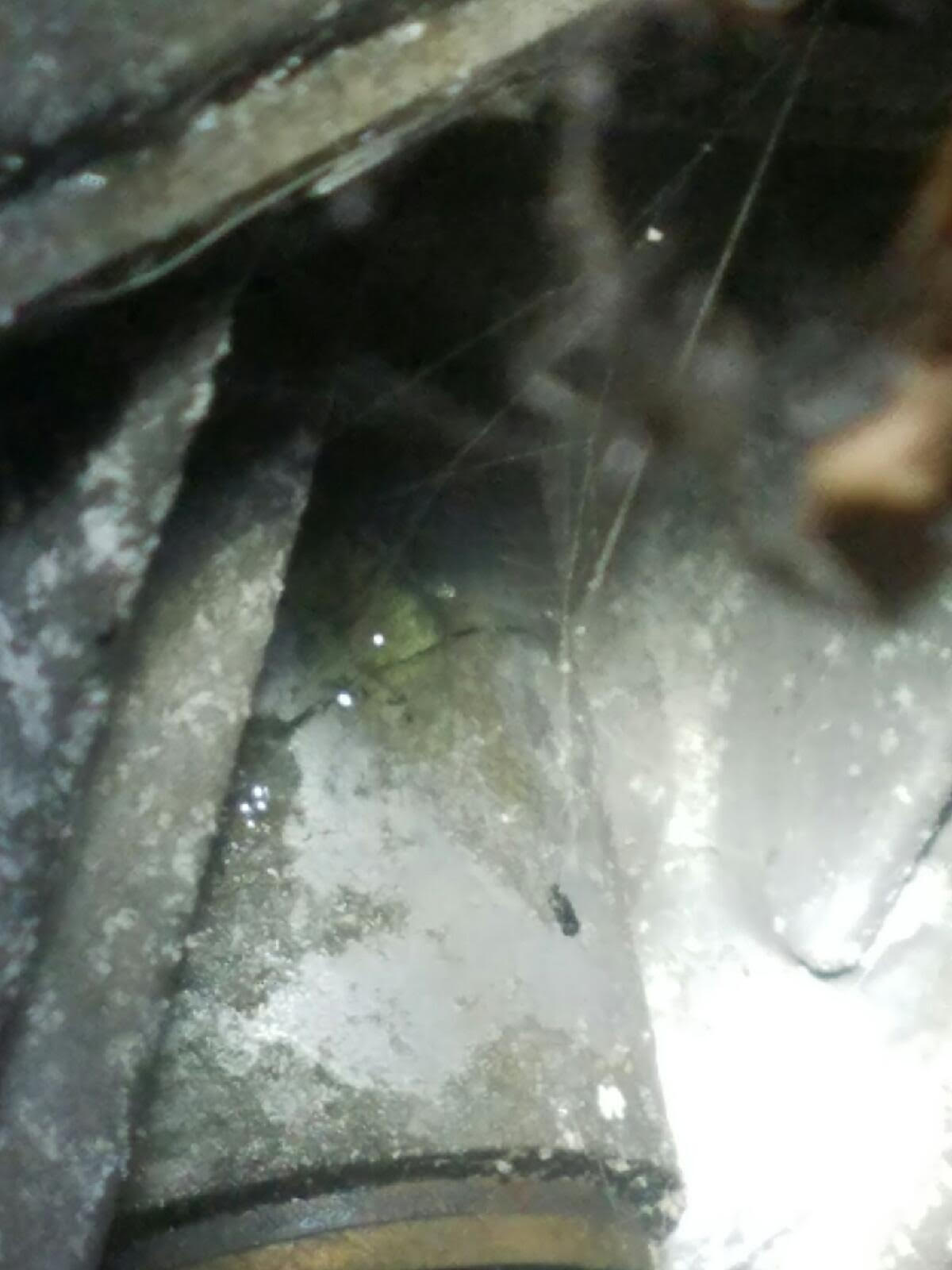

welp unfortunately i found the source of the coolant leak.
the only question remaining is there any sense in rtving or jbwelding this crack for a temporary fix? naturally i know this will make some cringe but im not rebuilding a race car here... looking for a temporary driver...
this is from the undercarriage looking up.
if you notice there is a thin crack in the aluminum block.
thanks in advance........
Note... The bottom of these pictures is the front of the car
It looks like if I remove thethe front engine mount I can get my hand up in there well I can already get my hand up in there but if I remove the front engine mount, i have a little bit of room to play with. the thing is is that its a cylindrical crack... so close to the mouth of whatever it's plugged into that it almost seems like I could just break the whole thing off and extend some kind of grommet.. I need names for where those cracks are and what it's plugged into because I'm not a welder but I'm sure I could talk to a shop.
