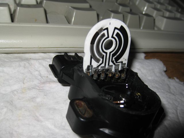

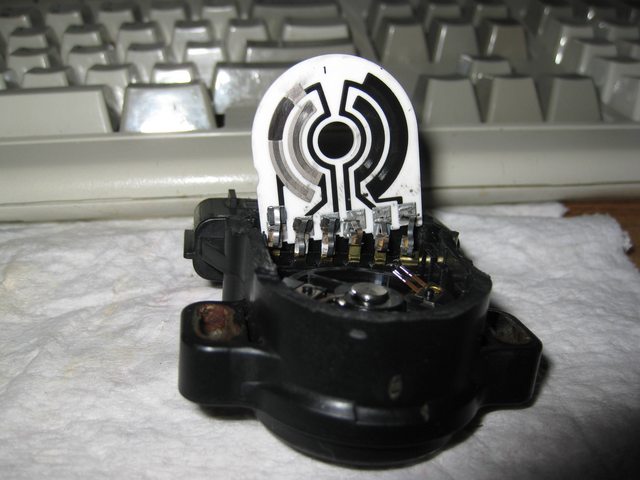

I got curious and took apart the old (OEM) TPS:
high-resolution
Looks like one side got entirely stripped, but maybe that's part of the redundant design. Thoughts?

Dont waste your time chasing the egr that isnt the cause of the stalling for sure ive deleted the egr off all of my maximas. The car will run fine with or with out it.Looks like you may have found your issue good luck
