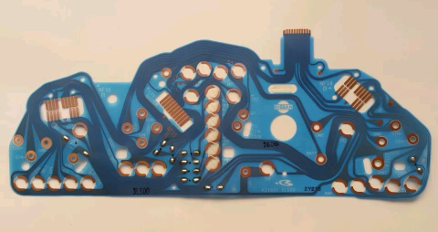

Recently my cluster was giving me problems , i tightned all the screws cleaned contacts nothing seemed to work. Until i swapped out the cluster plate on the 96 and it worked. Nissan still sells them. Looks like this, 97 is the same as 96 just with new look.

Wow that looks crazy different but it hooks right up Gauge screws and all?

This cluster plate is from 98-99 it is different.You need one from a 96 similar to the pic i posted. Im not saying this will fix your problem. This worked for me. Even after fixing the problem i still swapped in the 97 odometer.
Attachment 9497
nissan part number?
