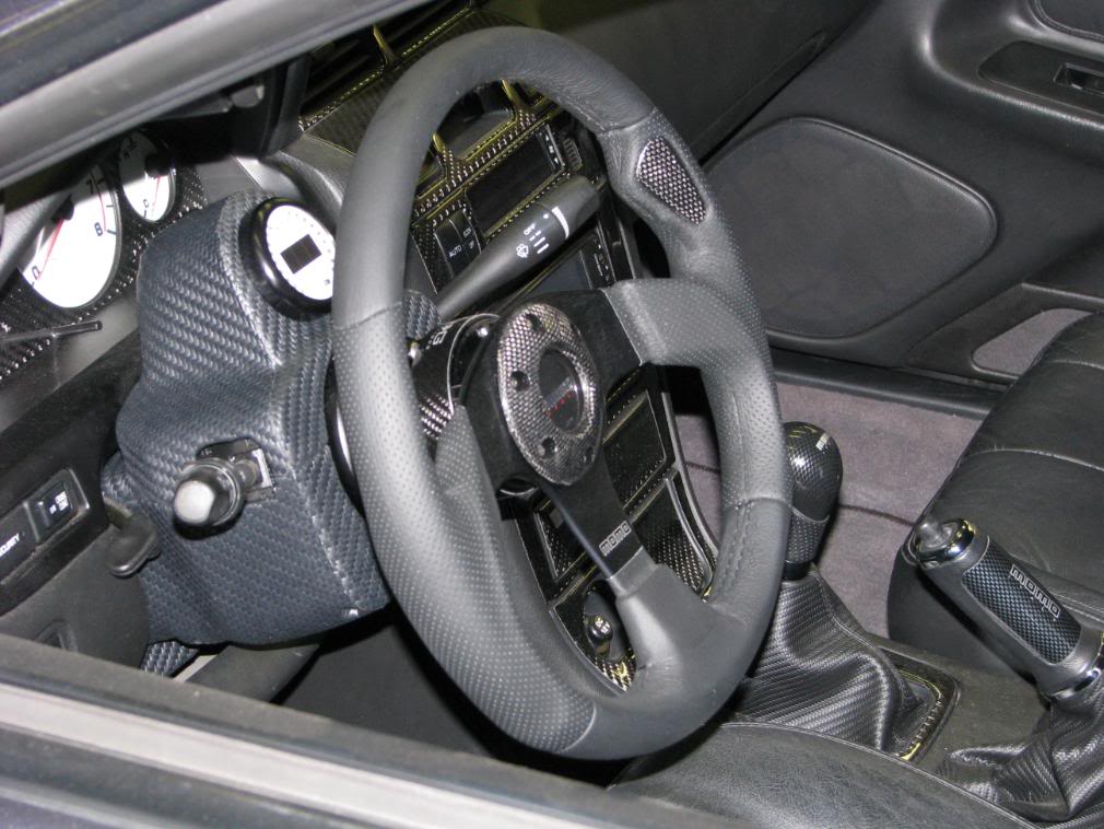

Old Sep 14, 2016 | 07:38 PM
Get a slightly smaller steering wheel, and problem solved.
This is what I did on my Max and I really like the tighter steering response as an added benefit.
