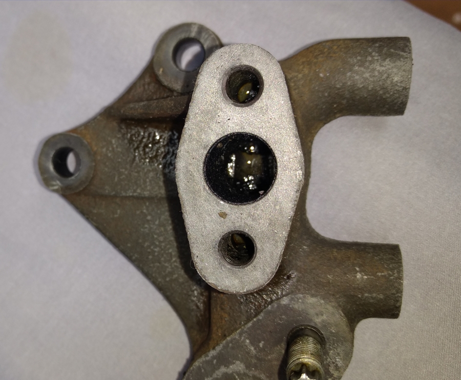

To prepare for Max IV's mid-life maintenance with new valve cover gaskets, injectors, and EGR hardware cleaning, I found a new technique for washing away rust that leaves metal (e.g. non-aluminium) parts squeaky clean without all of the effort that I previously put into cleaning parts.
Here are some pictures of the finished products below.

EGR Mount After
EGR Mount Before
Surface Rust on EGR Mount

I used a 1 to 4 part mix of muratic acid to tap water as directed by the product.
Using a powerful cleaning comes with additional responsibility.
WARNING
1) Do not get any of the acid or solution mix on your skin.
2) Wear eye protection when working with the produce or mix.
3) No not inhale any of the product vapors from around the cleaning bucket.
4) Use a plastic container for dipping the product.

Awesome stuff. How long do you dip the metal in for, and how can you tell if it's too long?

Over night seems to work best.
There really is no "too long".
The only step I'd add to Craig's process is that once the dip is complete the parts need to be sealed/protected from further/future corrosion.
I've typically used an over night soak in motor oil.
But with the EGR assembly I'd not recommend that as you don't really want much, let alone a viscous petroleum product, inside the orifice(s) and tubing.
The alternative I've found most effective is this stuff applied to all external surfaces and hardware ...

Good point Turbo. I let them soak for roughly 6 to 8 hours while I worked on changing the crankshaft pulley.
To keep the rust from coming right back, I sprayed them with WD40 to keep them sealed after the dip. I will clean, prime, and paint then with header paint before installation.
Here's how the finished parts will look when I'm done. I had some extra EGR parts that I'm getting ready for the Max IV project. I want to be able to work fast once I start that project.
