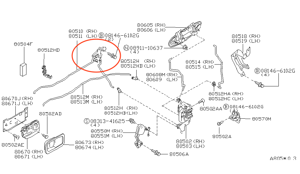

There's an adjustment that can be made on the door lock tension. You loosen the nut on the connector and manipulate the rod back or forward while checking how easily/difficult the thumb lever in the door handle operates. Maybe it has worked loose? Worth a shot. Here's the exploded schematic with the part circled ->

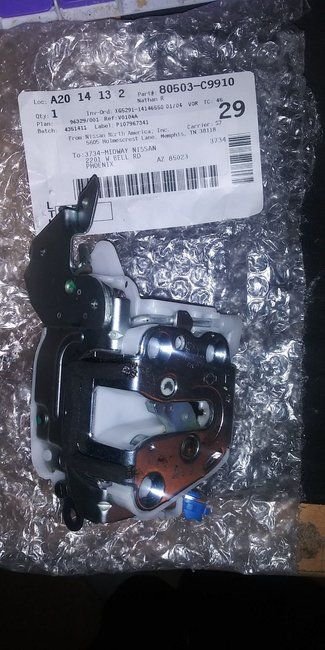

My driver's door had this issue. It was the latch. $240 OEM, new. I couldn't find a 4th gen. in a junkyard anywhere near me. This part:
