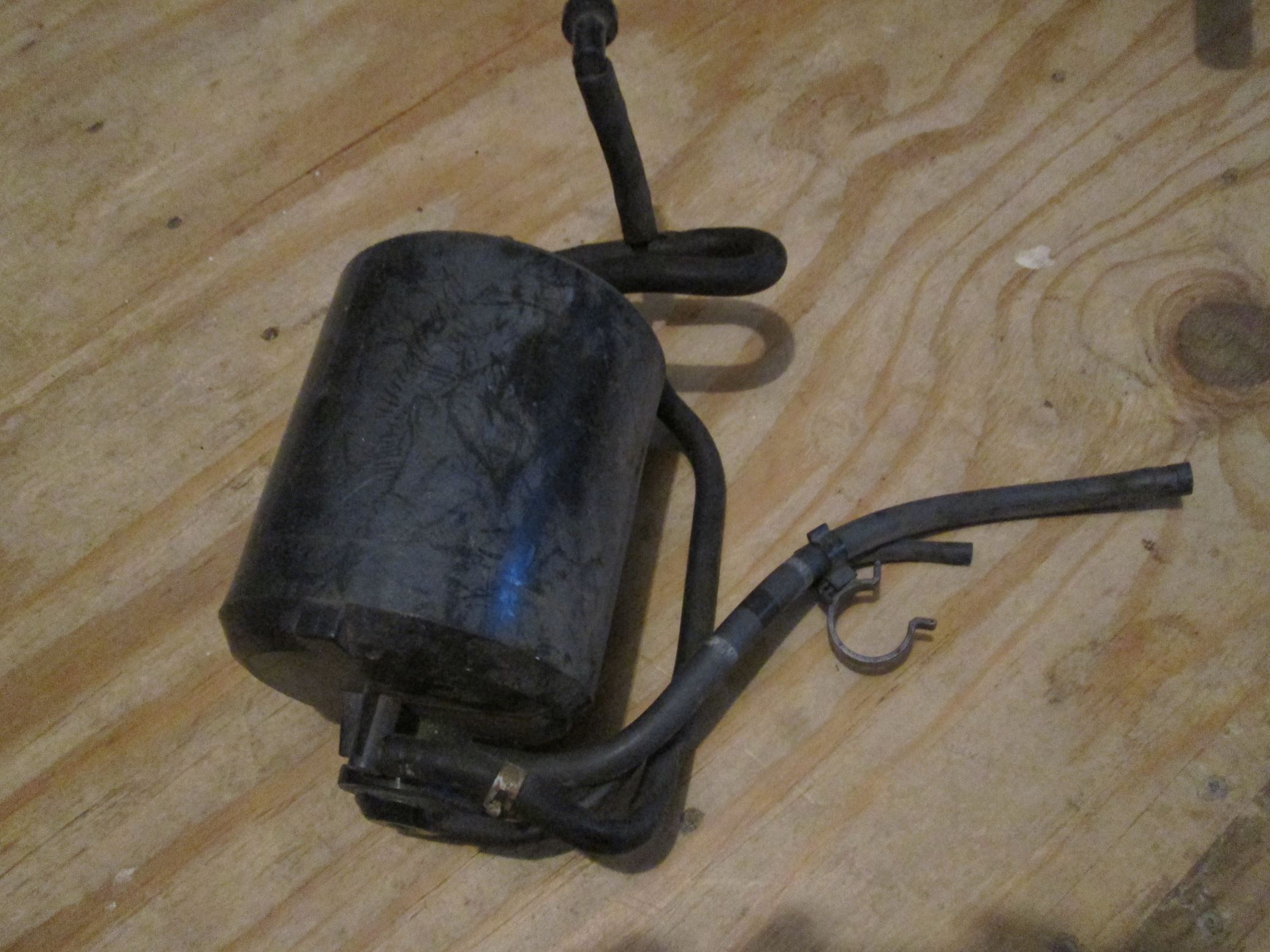

It has no ties to the ECU at all 0%. you could tear it all off and the car wouldn't even know it.
I have one that i could sell you it was taken off a 8 year old 95 max(but it was in the junk year 2-3 years of that). I was gonna convert my race max i had years ago. To that setup. but just deleted it altogether . It is a little dusty been sitting in a box for a long time. I can clean it up and take a pic if you would like

Originally Posted by CS_AR
I found a thread with a picture of the round canister in the link below.
This picture does NOT match the 95 max canister. The 95 bottom doesn't look like that.
