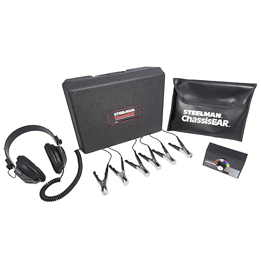

Here's a picture of the chassis ear set I purchased to HOPEFULLY find the issue.

Now I want to try it on different parts of the engine and other parts of the chassis for fun. That tool is so much more powerful than a mechanics stethoscope. I like how you can listen while driving along.
