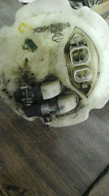

It is not the fuel pump itself, is is the sending gauge unit, the nylon top part that seals the unit in the tank. It has developed a crack.
If you take out the rear seat cushion and remove the cover plate in the floor, you will see the pool of gas that builds up there.

Now that is what I believe is the issue. AWESOME! Thanks!!!
