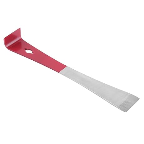

I've had the best experience using an adjustable head Lisle 56650 like the one in the picture. That one disappeared after the first or second use. So I need to get another one someday. The swivel head makes all the difference in reaching into the passenger side area. I think I filled down the tip on the long side so it would slide under the seal with less effort.
The most unconventional tool for seal removal and gasket contact area clean up is a beehive scraping tool.
