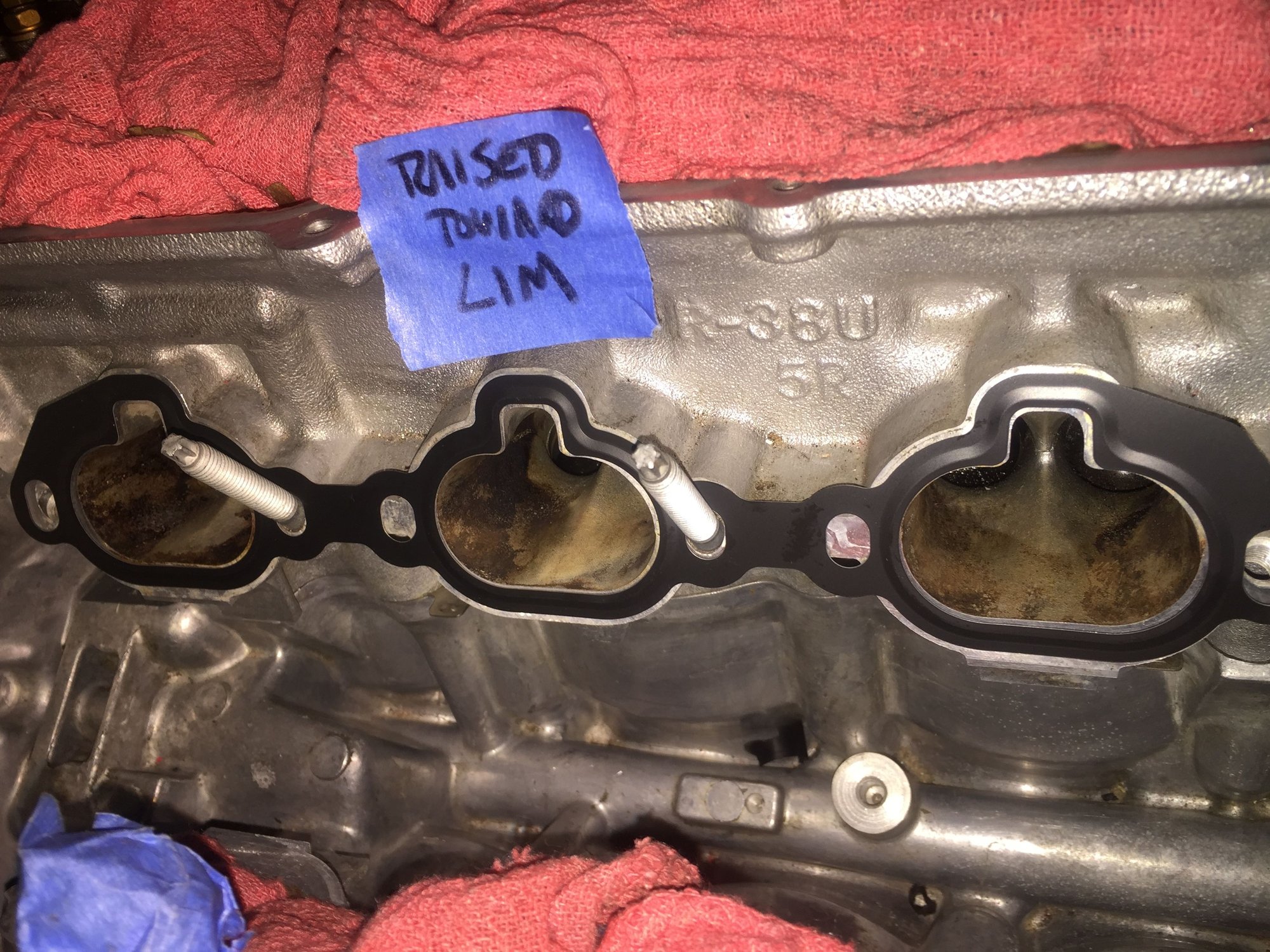

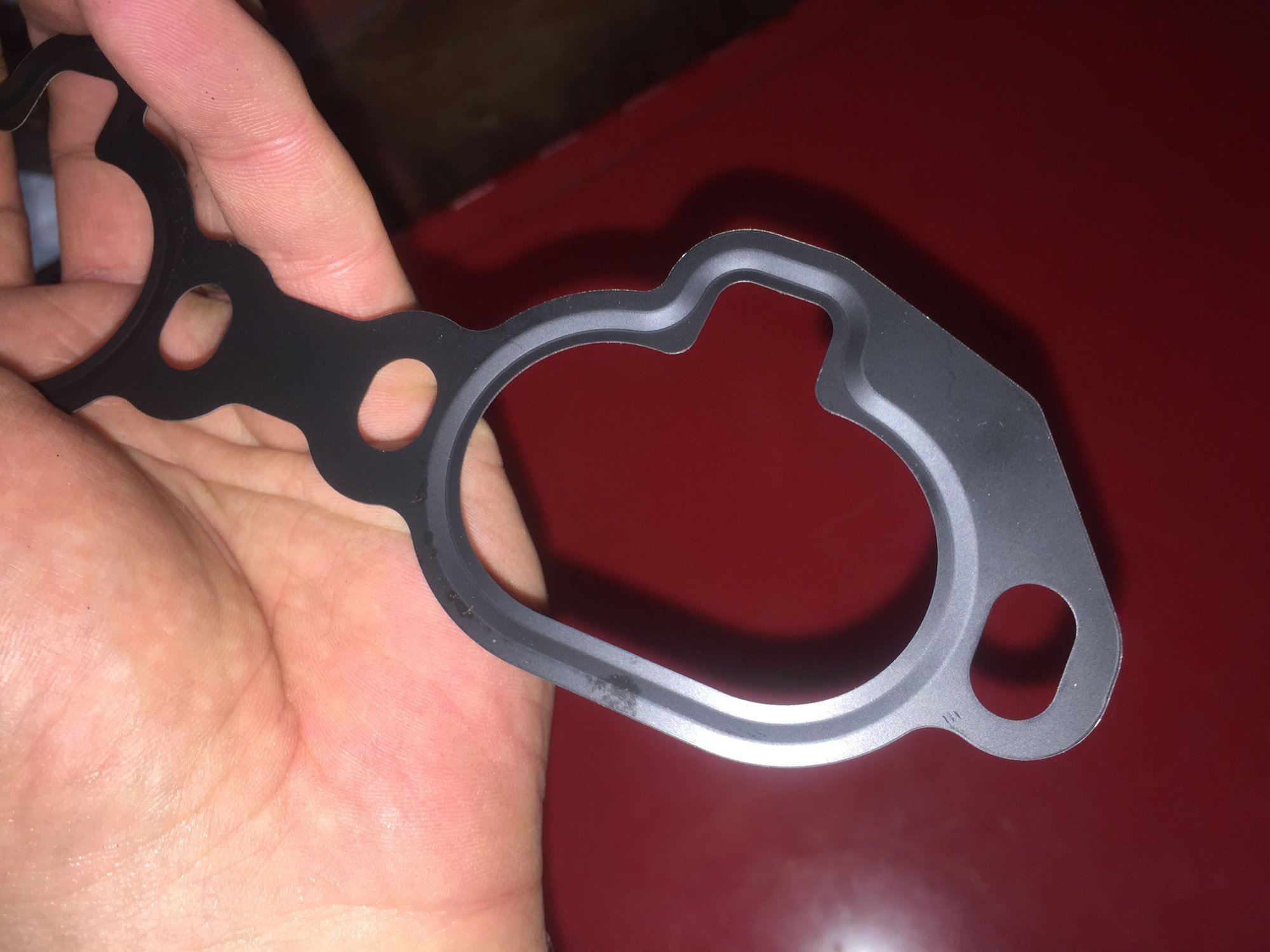

Pictures below. Each gasket can only go on one way - but which way ?
peak of the ridge facing away from camera
peak of the ridge facing camera
on the LIM, peak to LIM
on the LIM, peak to head
on the head, peak to LIM
on the head, peak to head

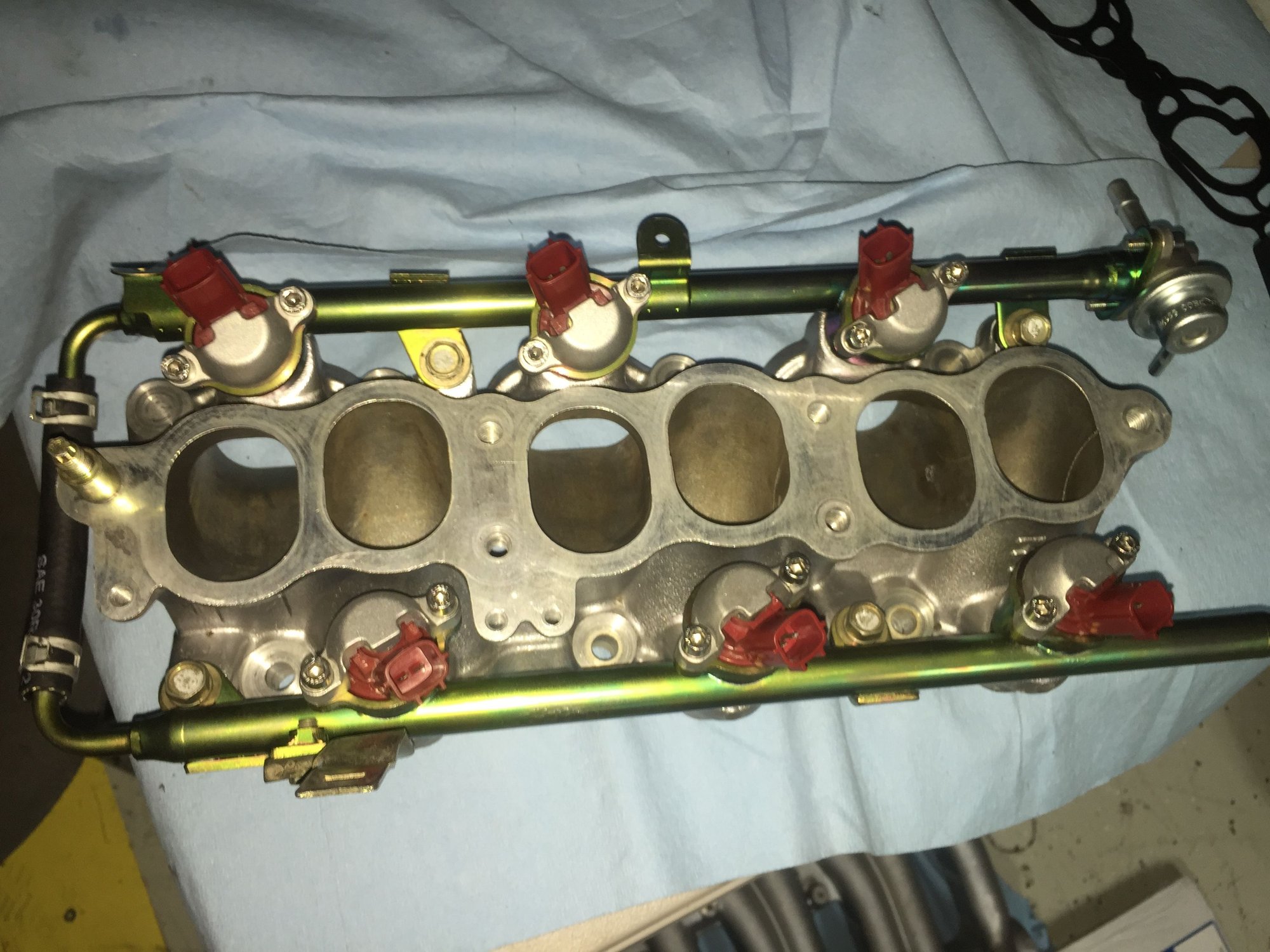

gratuitous pic of LIM with fuel rail

Both surfaces it's mating to are flat, why would it matter? Either way it's going to get pressed down against a flat surface. Just make sure the gasket doesn't partially block the ports and matches up well when you go to tighten down

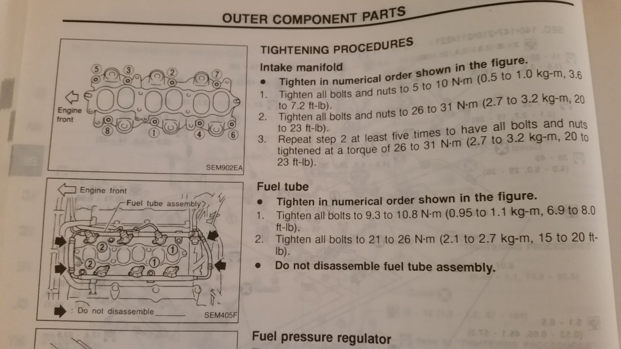

The FSM does not clarify the orientation.
What does matter is the torque specs.
hey I recognize that book
indeed there is no documentation anywhere re: intake manifold gasket orientation

IT doesn't matter...It's there to act as a crush gasket only almost like an oringed combustion chamber
That being (apparently) the case, I will place "the flat" portion of the gasket against the head, and I will place "the raised" portion against the LIM.
