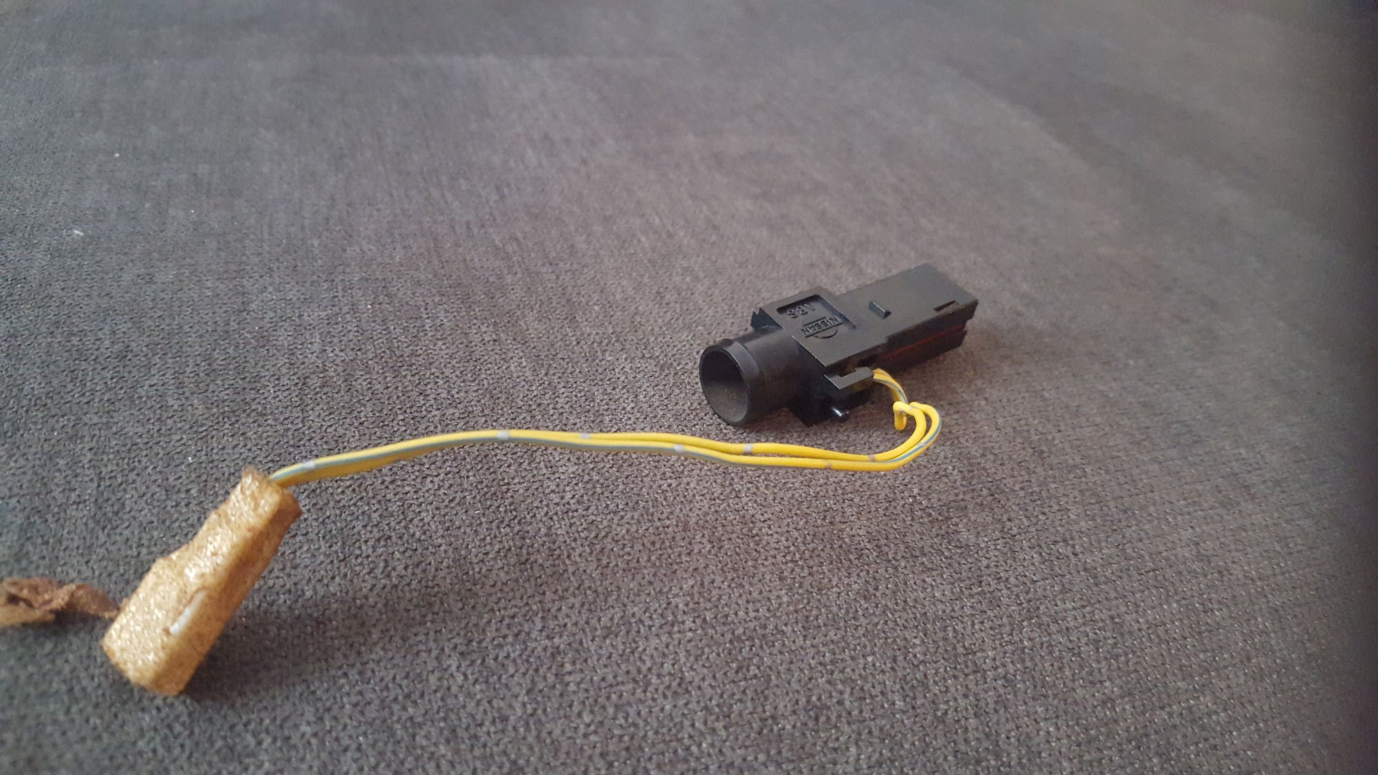

Auto climate control sensor
Anyone know what this part is and if it would cause my recirc/defrost function on my a/c to not work. My car is a 98 with digital climate control, the a/c still works just not able to recirc so im not breathing exhaust fumes while in traffic

It is a temp sensor for the cabin.
Have you run the self diagnostics yet?

22 is the code for the in-vehicle temperature sensor. It has failed the test.
25 is the code for the sun load sensor. If you did not run the test outside in the sun or was inside a not brightly lit garage, it will fail the test. If you were outside in daylight and got this code, then the sun load sensor is bad.
30 is the code for all the tests in section 3 completed successfully.
But the problem of not being able to get the recirculate air function to work would not be any of the codes you mentioned, nor would those codes cause the problem.. It would be a code in section 3 of the tests, most likely code 39.
Code 39 says the motor that moves the vent duct door for recirculate is bad. But the motor could be good and the control panel with the buttons could be bad and this would not cause a code. Another possibility is that the connecting arm between the motor and the air door could have come off.
Take out the glove box and look up in there while you press the buttons and see if the arm is on and the motor is moving.
