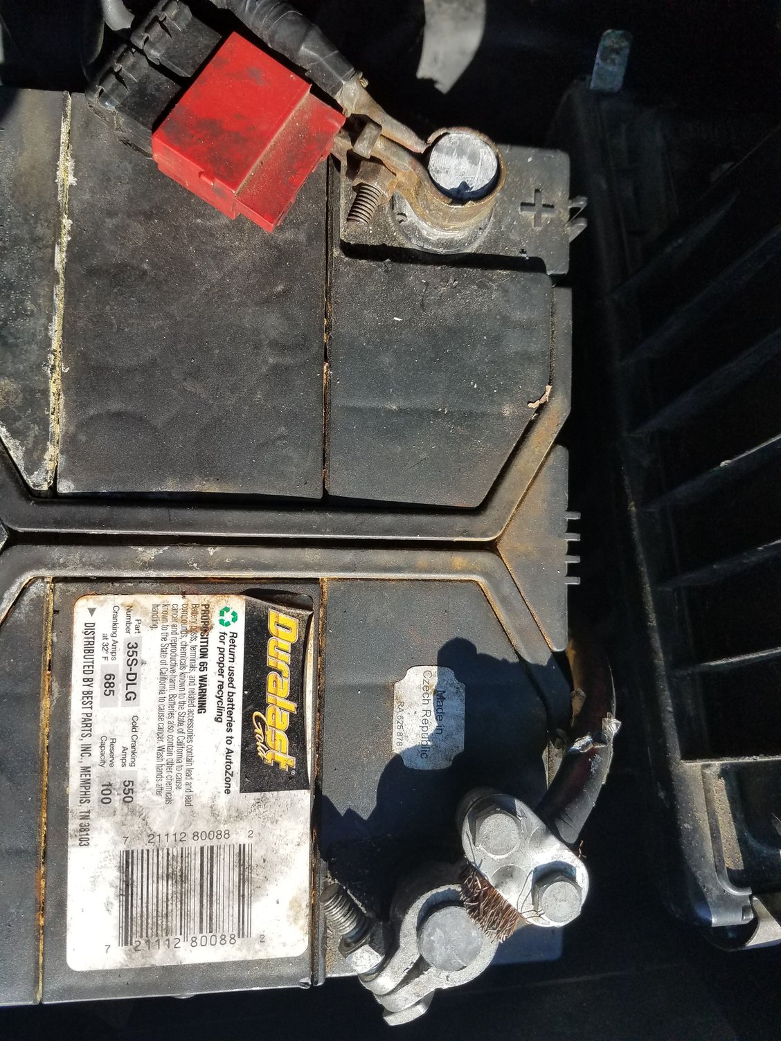

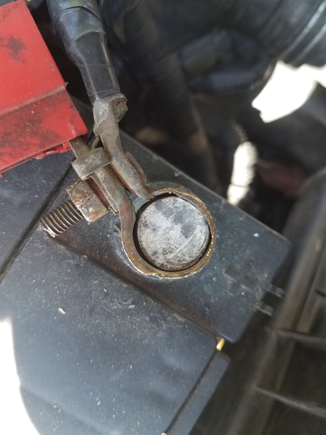

Old Jul 29, 2018 | 03:18 PM
tbone6812's Avatar
Joined: Jul 2018
Posts: 11
Hey fellas here are the cables and just for extra knowledge. I tries to start the car it turned over rpms went high then lo and ered but stayed crunk Tties again after it turned over and gave me that dead drain condition then started..
Old Jul 29, 2018 | 03:24 PM
tbone6812's Avatar
Joined: Jul 2018
Posts: 11
Sorry to repeat but i could not figure the edit button out. Hey fellas here are the cables and just for extra knowledge. I tries to start the car it turned over rpms went high then lowered but stayed crunk. I tried again after it turned over and gave me that dead drain condition then started. Rpm's went up came down very low again but maintained being crunk.
Old Jul 29, 2018 | 10:02 PM
CMax03's Avatar
Posts: 9,587
From: Houston, Tx
That Negative Battery terminal looks loose or like it's not too tight...Change both to new heavy duty battery terminals...
1. Be sure to test battery voltage with the engine not running...
2. Next check your Battery voltage with the engine running...no lights, nothing on but the engine!
3. Next check your battery voltage with the engine running and every load on headlights, foglights, rear defogger, blower fan on full, caution flashers, interior/door courtesy lights, radio, etc...13.0 v-14.5v you're good....anything below 12.5v you got either a dirty ground, loose ground...anything lower than 12.0v your definitely have a defective alternator...

You definitely have one loose loose factory connector. You might try wrapping a bit of aluminum foil around the battery terminal to intense it's width. That might help create a tighter connection. This is only a temporary fix until you can fix it right. The clamp on terminal wire does not look good either. Did you remove the clamp from the cable, then sand both the terminals as well as the cable till both are shiny?
That photo is a huge clue abut why your car is acting as it does. Replace the clamp on terminal with something better.
What's happening is that there is not much contact between the battery posts and the metalast in the terminals. So there is not enough room for lots of electricity to flow.
I am going to order like I said both and replace them with brand new ones and hope that is the remedy. It may take a few days to get them but I will let you know how it turns out, Thanks again.
