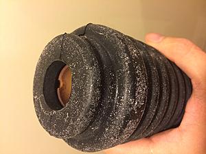

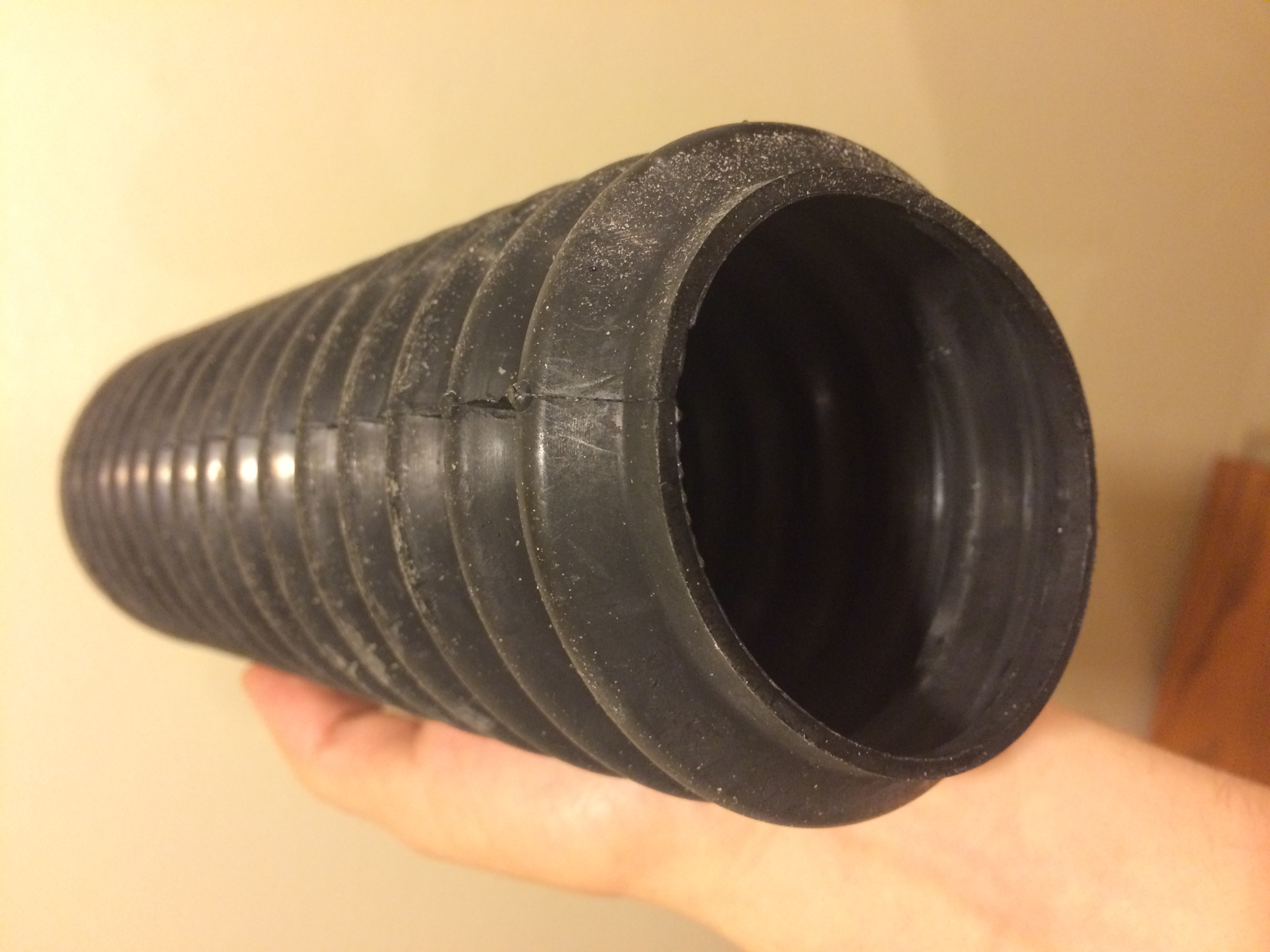

I haven't had one tear yet, but I'll be keeping an eye out.

I haven't decided whether to also change the strut mounts and strut boots (some people don't seem to think the boots are that important).

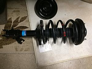

Amazon has the Front Koni STR-T struts for $121.38 each shipped. Koni has a lifetime warranty.
SE Strut Mounts: Always take the "Nissan and Part number" (Nissan 54320-40U02) and enter it into Google and find best shipped price for OEM.
You also need OEM Strut Bearings Nissan 54325-5V000. You need two so shop for best price delivered to your location.
And new OEM other rubber parts for a brand new feel. Anything with rubber, no matter how much we want to believe they are fine, are truly a consumable and need replacing when strut assemblies need rebuilding. Bearings too. All Consumable. And that means new OEM bellows too.
A year and a half ago, "93SCMax" had a set of 98 SE springs for sale that are as clean as you can ever hope for. PM him if you want them. He might still have them.
By the time I was done with new everything, a spring compressor kit, used springs from CS_AR (very reasonable), the total cost was approaching 4900 with me doing everything myself all four corners. I spent way more than that buying three rounds of noisy and failing crap to get there. Money well spent..... FINALLY. Better than new. GR2s were the first time around. Rode like solid poles with no absorption. The mechanic replaced them free after he drove it after over 1 year. Hopefully those KYBs aren't like the GR2s. HORRIBLE!
When you're done, hopefully you'll have this:

As far as the bellows are concerned, it seems GXE are specced with 54050-31U02, while GLE and SE are specced with 54050-38U02. All versions are specced with the same 54040-31U02 spring seat. Kind of weird.
54050-31U02 seems to have the integrated bumpstop - I still have those on the car, the bumpstops are broken and cracked, just like the bellows.
54050-38U02 seems to have a separate bumpstop judging from Craig's photos.
Update: I ordered 2x the strut bearings, 54050-38U02 bellows and spring seat insulators ($138 shipped)

6 days ago, I did the dirty deed, it took me 11 hours, and I had the gaskets cut ahead of time.
The old mounts were fine, one bearing had 1 crack at the edge, another was fine. Both bearings seem to operate fine, amazing how those little plastics can hold so much weight. The spring seat insulators were not hardened (neither was the rubber on the old mounts), but one of them had a hole where the coil end sits. The frugal could have reused them by having the coil end sit in another spot. The frugal could have reused the mounts and 1 bearing. But I had all the parts ($230 worth) so replaced everything.
Being skinny, compressing and decompresing coils twice was a pain, especially because I had to use a spanner - a socket had no clearance on at least one side. I also had to add a third compressor at times.
I cleaned and painted the coils and spring seats.
I ended up lubing the spring with dielectric grease, held the spring with my thighs and with both hands I was able to slide the heatshrink rather easily (this was my worst fear about the job).
Heatshrinking was a killer, I did not expect that amount of work and time spent, easily 2-3 hours; amazingly the HF heatgun survived the ordeal. I used 24" of the heavy heatshrink on the bottoms, 12" of heavy heatshrink on the tops, but past the first loop. I used some 3/4" Temco heatshrink on the first top loop, much thinner, but maybe enough. The first top loop contacts the rubber insulator, just a reminder.
I had contemplated filing the end of the top coil, to make it more flush where it would contact itself, but forgot about it, as I was stressed about not finishing up on time (friends garage, had my 3 year old with me, mental wife at home).
I ended up with Sachs SuperTouring front struts (290086 and 290087) - the brake hose bracket did not fit, so some PITA enlargement and filing was needed. Unlike some photos online, these old stock ones (I believe made in 06 and 07) did not have elongated mounting holes fortunately.
At first, the ride was pretty rough, more thunk than before. After a few days and some less 3 psi in the tires, the struts gave in more and ride is better (or I just accepted it). I can definitely say there is a difference in larger potholes for the better, more a thud, and less vibrations, not sure whether from the heatshrink or just the new struts.
Of course, with new struts, the Cadillac ride is gone, but the handling is more confidence inspiring, less nose dive etc.
Ride height is about 1/2" higher in the front, but there is still a 1/8" ride height difference left to right. I may not measure the ride height in ideal conditions though.
Springs seem stiffer, I don't know how much of that is the heatshrink and how much is new struts.
I am trying to get a free alignment check soon.
Thanks for all the help, especially KP11520 and CS_AR!
