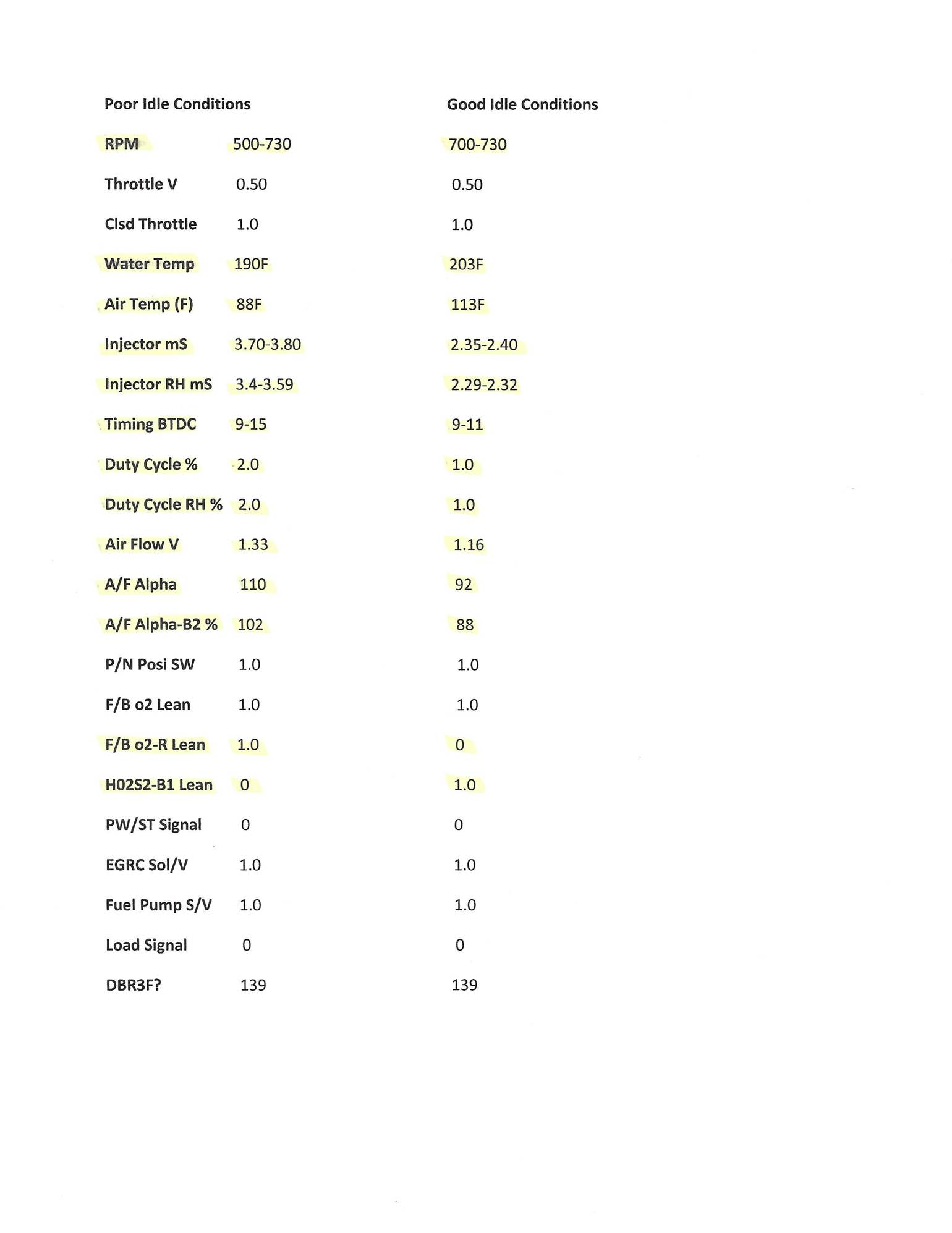

Plugged in the Nissan-14 Conzult and ran some live data during poor idle and good idle conditions. Here's what I got. Hope someone knows how to read this bc I don't understand any of it.
Nissan-14 Conzult ECU Talk Data

Vacuum leak test complete. Haven't tried any seafoam or injector cleaner yet. Whats the proper/best way to get those done?
