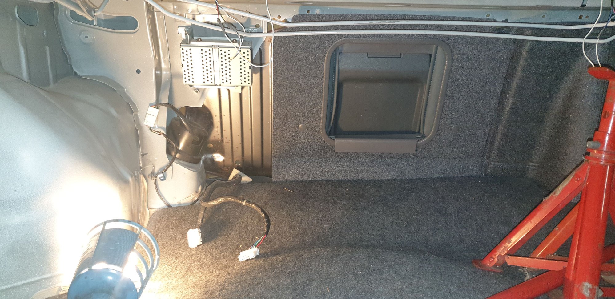

Nah nah nah, tried as hard as possible to avoid touching the nissan harness. The stock unit was a 2-din clarion cassette and radio and I've actually just located the amp (FYI it is in the boot bolted to the back seat located on the passenger side behind the material boot liner).

That is an aftermarket amp. Nissan did not use one - at least in the North American cars.
If you need an amplifier on wire, tap into the blue/white stripe wire in the Sony wires that is labeled REM OUT in the Sony installation guide.

This is an Australian import so I'm not sure what the factory options are but that amp is definately factory.
