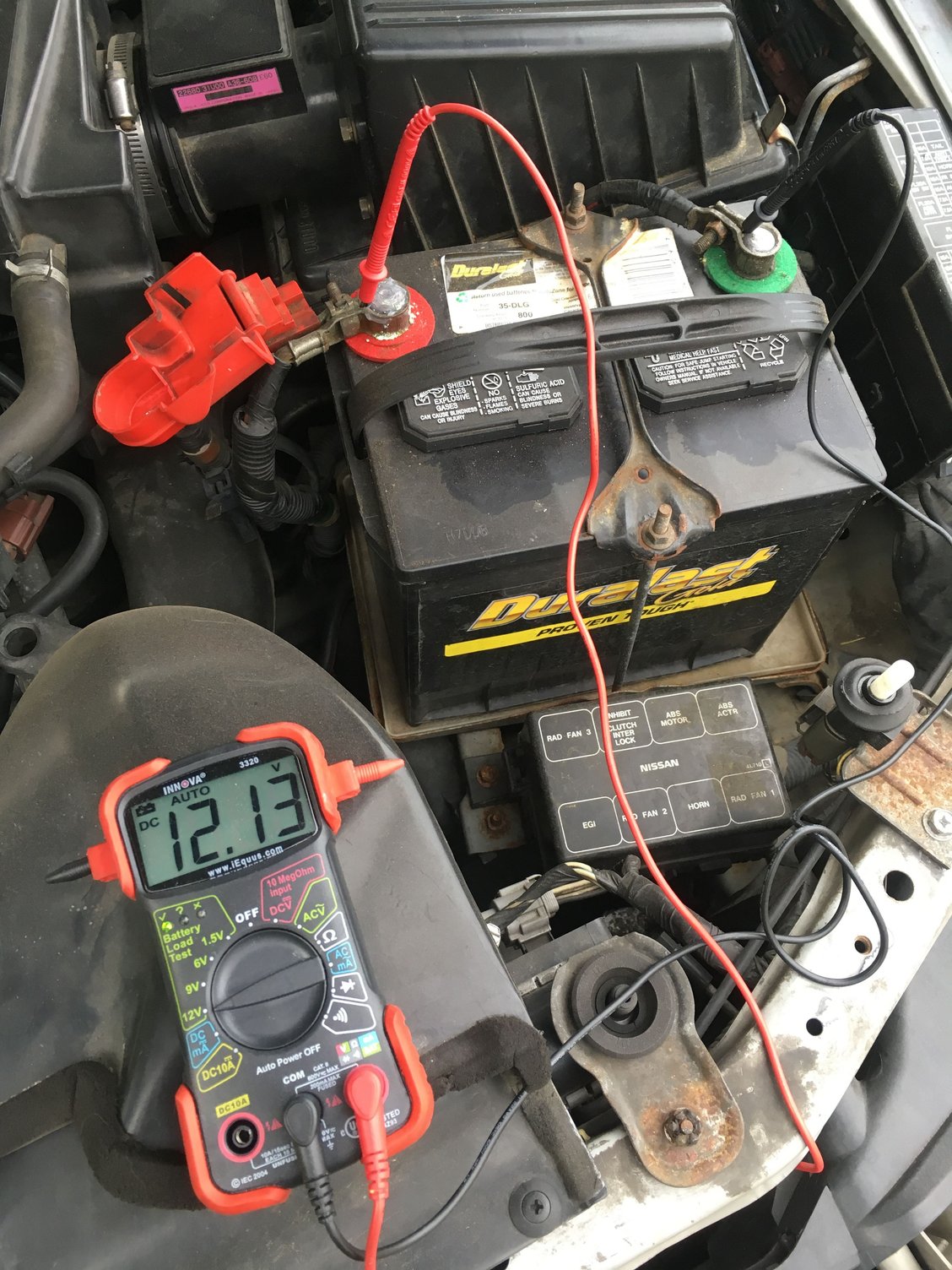

Ok ran a voltage test:
The AC / radio / headlights were running from the start. Voltage was at 14.09 until I ran all those systems and it dropped to 13.87
i then pulled up on the front two window controllers and then the rear two *in addition to* the front two.
the results are in the video.
Battery was replaced last in August of 2017; It’s some autozone gold thing.
Aternator was put in during August or July of 2015. It’s an autozone rebuild and I blame it.

I asked what the battery voltage was when NOT RUNNING. If your battery is weak (not around 12.5 volts), it might not supplement big watts draws. 14 volts @100 amps is 1400 watts. Ask AZ how many watts their gold crap puts out?
I'll tell you what else might be suspect, the wiring (usually between the door and body) to the driver's door for the power and ground to the main switches. Maybe even the switch. But battery non running voltage will tell us where to look next. Get that first thing in the morning after a night of sitting. Also make sure the battery cables are secure and CLEAN on both ends with no compromises anywhere in between.
Another test would be with some help. hit all separate door switches at the same time and see what the DMM says then. That would take you away from the Alternator if the voltage stays higher when doing all the windows. Put them UP. Draws more juice.
But the whole concept of an alternator clamping down on an idling engine to stall isn't anything anybody has heard of. What happens is it just doesn't make enough electricity and adds some strain on the engine that the ECM compensates for. And even the voltage didn't drop so low that it starved the coil packs for juice for a stall. It's either something else or multiple things IMHO.

Ah apologies for not posting the battery voltage. Testy today
It was at 12.13 when the car was off - this was after sitting all day yesterday without being used. I had driven it the day before.
Also, take a look at my earlier video as running all 4 switches actually did kill the car, just not this time... I have been advised to get the battery tested by a friend.

Trying a reroute of the electricity from 4 different places to see if that changes anything.
This one isn't straight forward, so we need some creativity to find and expose a possibility!
Think about it. Your car starts with 12.13 volts. Why would it stall above that? There is something else going on in there.

Ok Autozone says the battery isn’t charged up. So that means the alternator isn’t doing it’s job?
Not sure how to narrow this down further... Probably need to buy a battery charger...

That could be because the battery is slipping and won't hold a full charge as well. Az should also be able to tell you if your alternator is puking too. Why didn't they? They are in the bag for both.
Realwildstuff here recently went through a whole alternator thread. He bought somewhere a volt meter that plugged into his cig lighter jack.
This way you can watch it and see which is failing. Alternator or Battery... Or neither.Or both. LOL

I now suspect that the car has a bad ground for the following reasons:
  • There is an audible high pitched whine when revving the car over 2k RPMs
  • I am experiencing odd symptoms with interior lights / power
    • Flickering LCD display lights / dial lights while driving with the lights on
    • Random hard starts every so often (has continued to happen since mid 2017 but never stranded me)
    • Red security light stays solid red after starting car, but car drives with no problem (NATS activation should stop the injectors from firing)
    • TOTAL loss of power from time to time after parking the car
      • Happened 3 times in the past week
      • Park the car, key fob doesn't seem to work
      • No interior door / dome lights
      • Trunk button doesn't operate
      • Car won't start *at all* - 0 power
    • After total loss of power (3-5 minutes?) car comes right back to life like nothing happened
      • Battery is new as of last summer (July / August of 2019)
      • Battery was fully charged the last time this happened, putting out about 12.63 volts with all the power off and the car dead (no interior power)
    • Replaced the alternator (for a second time) in July of 2019
      • Need to load test the alternator, but due to the random power / no power / power when the battery was fully charged and the car was off I do not immediately suspect it.
What is the easiest / simplest / cheapest way to address the bad ground issue (beyond just sanding the mating surfaces) in order to resolve this issue?
  • I'm thinking of running a second ground cable from the battery to the frame or current ground point.
  • Are there any good how to videos regarding the "big 3" upgrade on this model?
    • I can't find them online with Google
    • Many of the references to guides mentioned in threads on maxima.org are now dead
