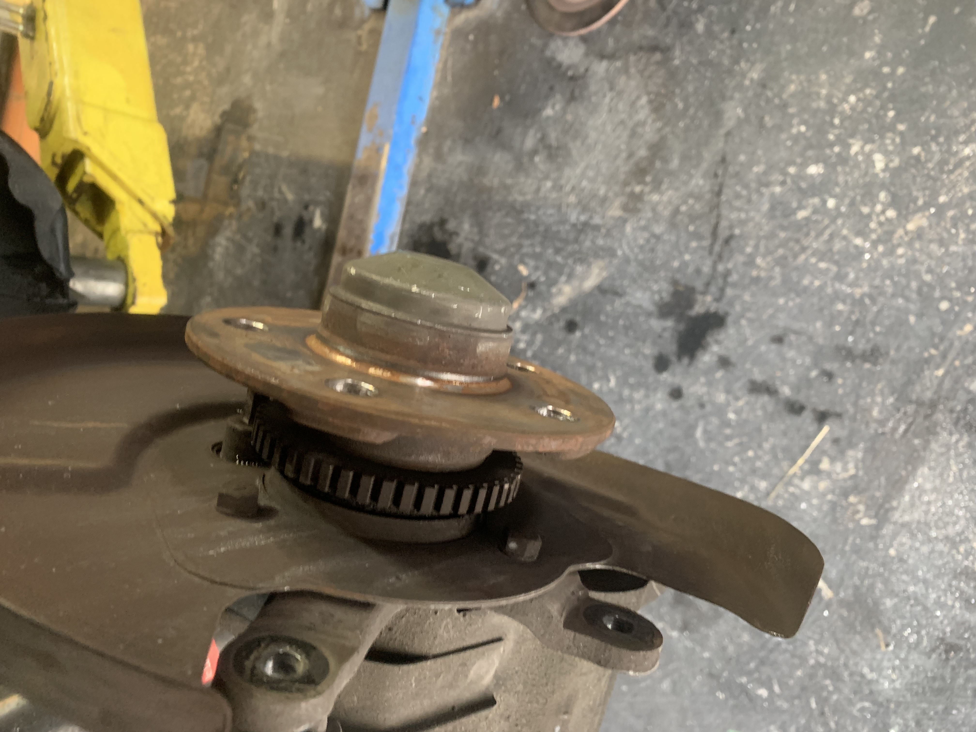

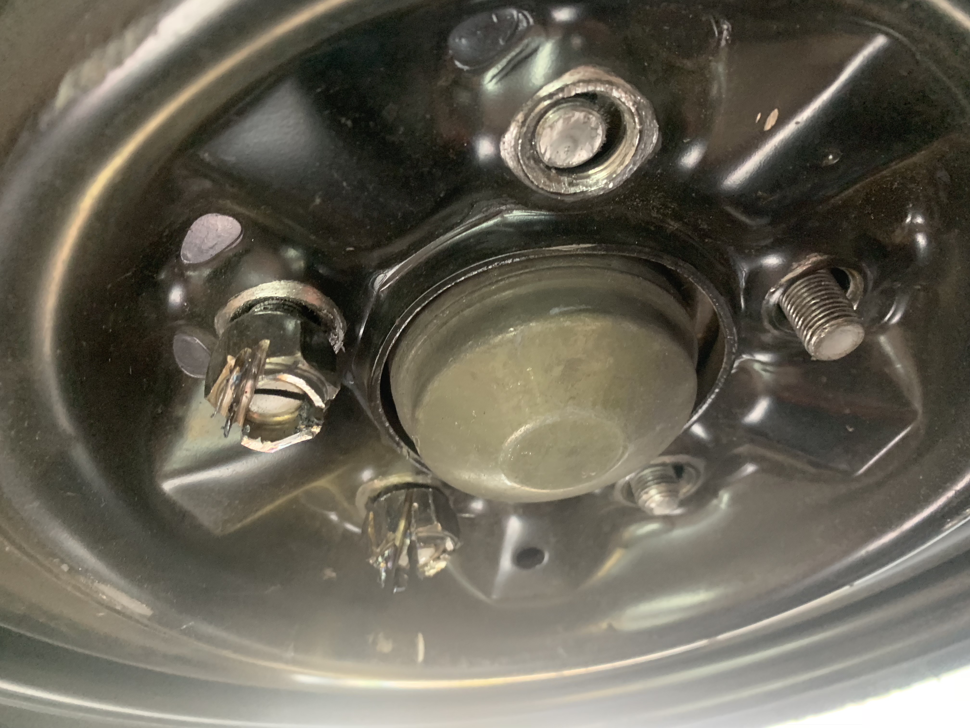

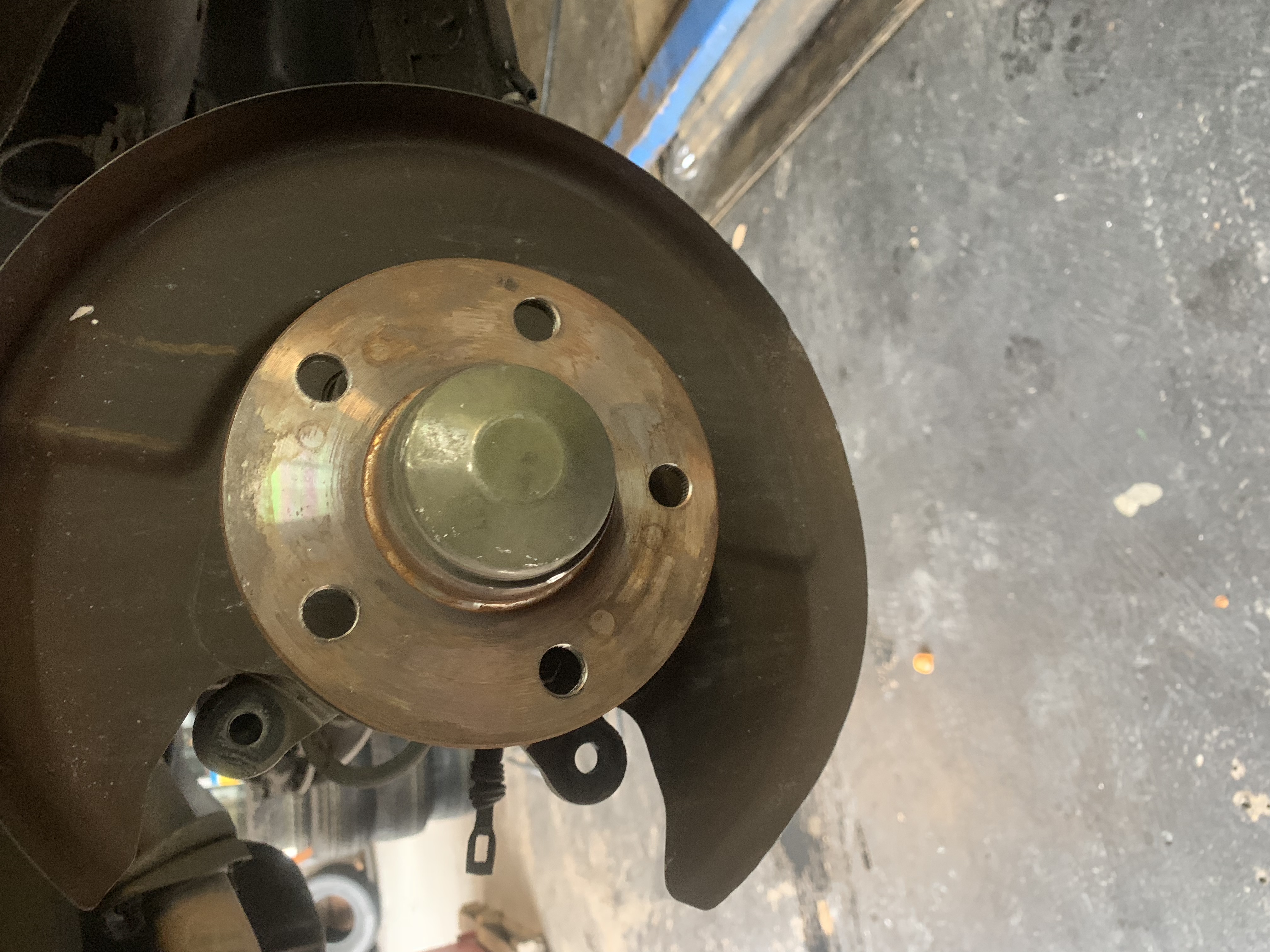

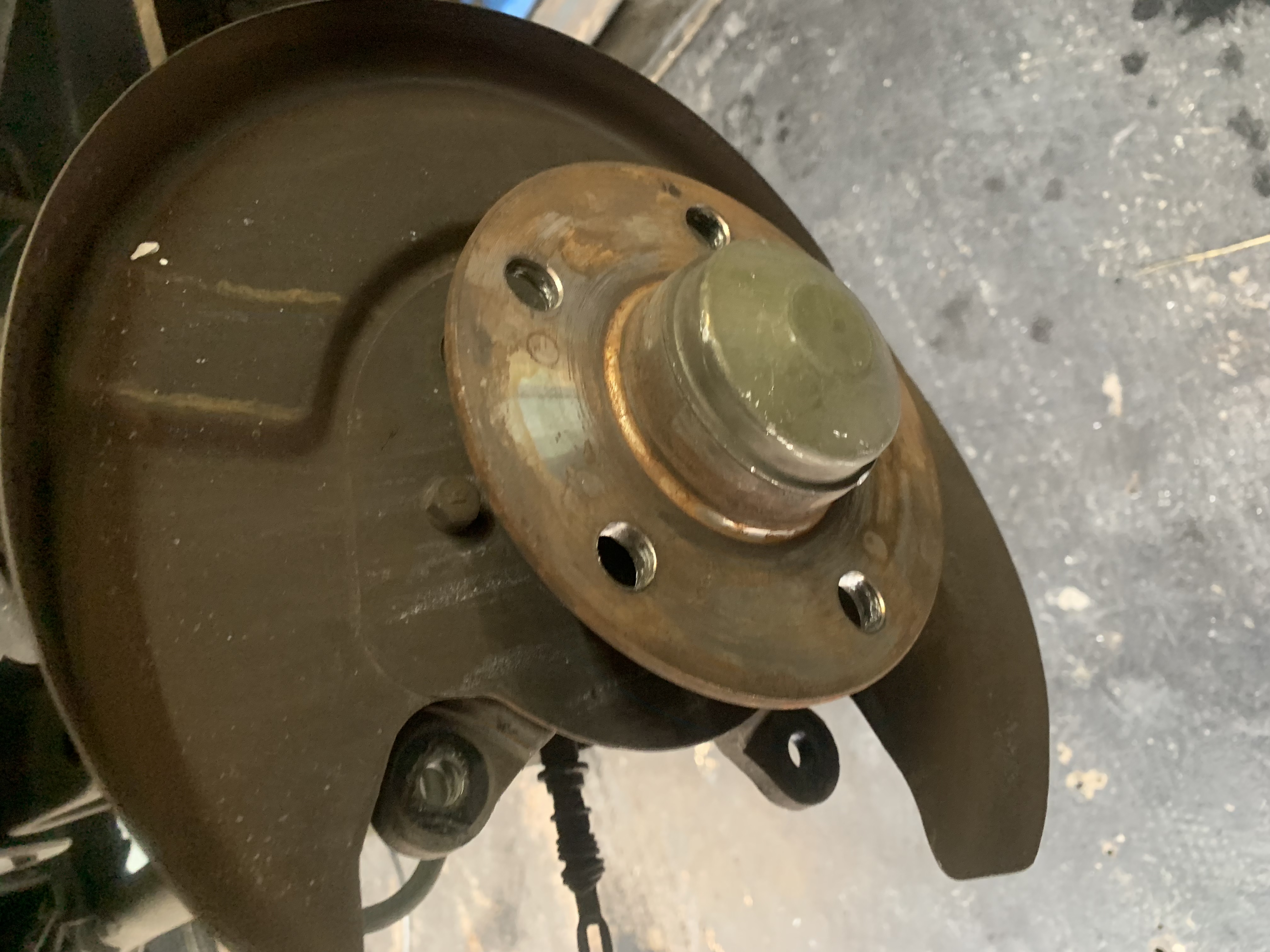

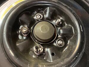

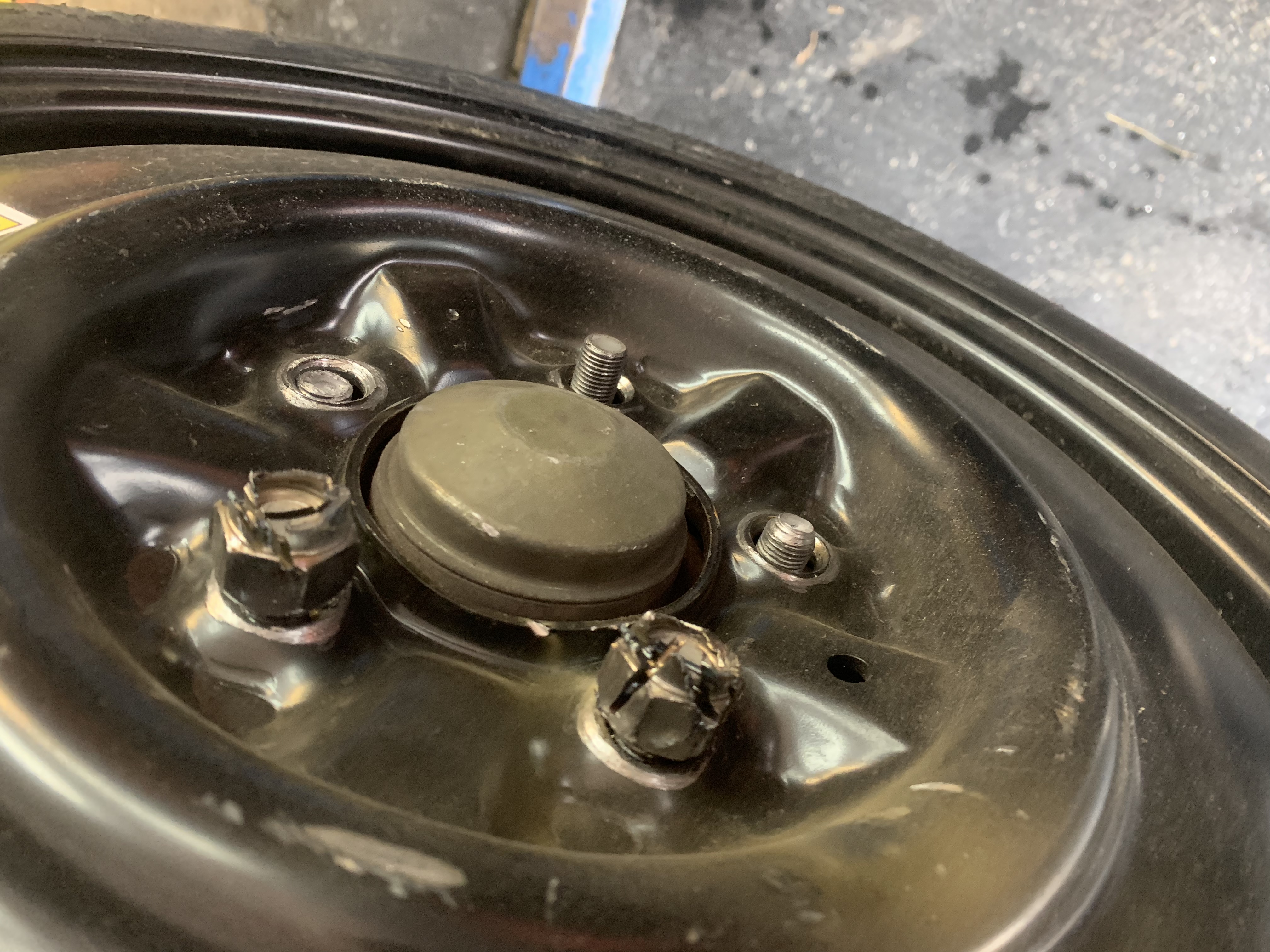

Pics
Attached Thumbnails Spare tire / lug nut and stud woes-b0f188bf-7f74-4c3b-8be3-047ea7ad76c5.jpeg   Spare tire / lug nut and stud woes-141d7877-1b7a-4735-a7cd-88353b87466b.jpeg   Spare tire / lug nut and stud woes-6ba02677-2d70-4034-ba43-2b91024248d4.jpeg   Spare tire / lug nut and stud woes-c08480c1-c45f-41f3-a2fe-b39c55fbfd1d.jpeg   Spare tire / lug nut and stud woes-922d56e6-88e0-46e5-8261-52f228ec2817.jpeg
Spare tire / lug nut and stud woes-13a1fa81-5bdd-43fd-be88-09f81dac1587.jpeg

Is the bore on the spare supposed to be bigger than the hub? Seem strange to me.
