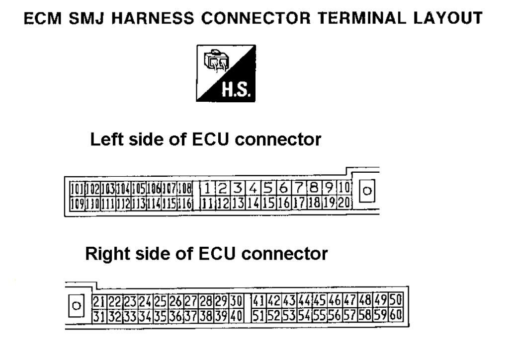

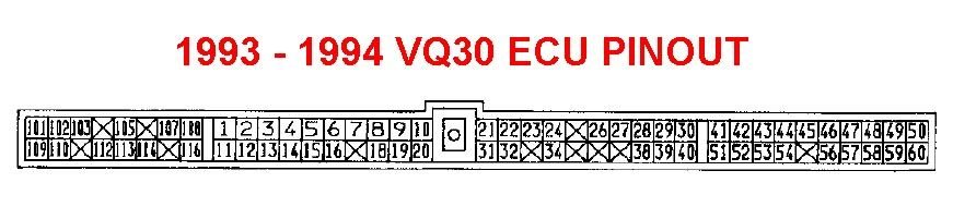

The photo of the blue connector is not a 4th gen ECU or TCM connector. It is for the 3rd gen North American Maxima ECU.
Is the Maxima you have a North American Maxima or on made for another part of the world?
ECU connector pin out for 3rd gen VE and VG engines.
Expanded view of 3rd Gen ECU connector pin out.
