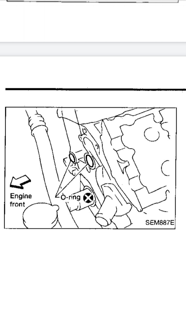

I think you are forgetting the two o-rings that go between the rear timing cover and the block (see photo above). These are notorious for leaking on these cars as they age. From what I see in the FSM, there are 6 total o-rings to do this job; the front crankshaft oil seal, 2 for the water pump and 3 inbetween the block and rear timing cover. The gasket set I pictured in my first post has 7 o-rings and the two smaller ones appear to be the two in question.

inner timing cover to crankcase
heres ya answer
