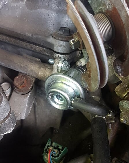

Stripped fuel pressure regulator bolt - what are my options?
These bolts were already chewed up being that they JIS and not meant for phillips but currently the top one can be removed but the bottom one is completely stripped
Things I've tried:
- needle nose vice grips
- chisel
- screw removal socket (the walls of the socket are too thick to fit in the ~1mm gap between the top of the screw head and the FPR)
- drill it out, even with larger longer bits I can only get within a 1/2 inch of the head straight on, or hit it at a very bad angle which probably won't be too useful and might damage the bracket it bolts into or snap the bit.
All I can think of now is a) hacksaw the FRP in half and essentially extract it piece by piece until the bolt is more accessible b) remove the throttle body in the hopes it will give me enough room to drill
Anything I'm missing?

GOT IT
What a pain!
1 - Removed throttle body except for the coolant lines since they looked like they hadn't been removed in 25 years and had become one with the throttle body, but that was enough for me to move it out of the way
2 - Drilled out the screw head, allowing me to remove the FPR
3 - I attempted to 'tighten' the remains of the screw by gripping the back end of it so it would twist out the back but it only got a few mm before I noticed there was a tiny bit of a flare on the end probably the first 1/2 mm of the screw head preventing it from tightening any further
4 - Used a mini hacksaw to saw that off
5 - Still couldn't turn it by hand so used a mini wrench to grip the back end and turn it one 8th of a turn about 60 times and it finally came out.

Sooo much better
I can't say for sure if the FPR was the cause of my instant start, 2 sec crank start, 2 sec then stumbling then start, etc etc, but I just started the car instantly 5 times in a row, so that seems promising since it's never happened even twice in a row before. Time will tell I guess.
I have no idea why that small vacuum hose fitting is pointing to the right instead of down like the old FPR but I was able to re-route that hose so it's not under much stress to connect at the new angle.
