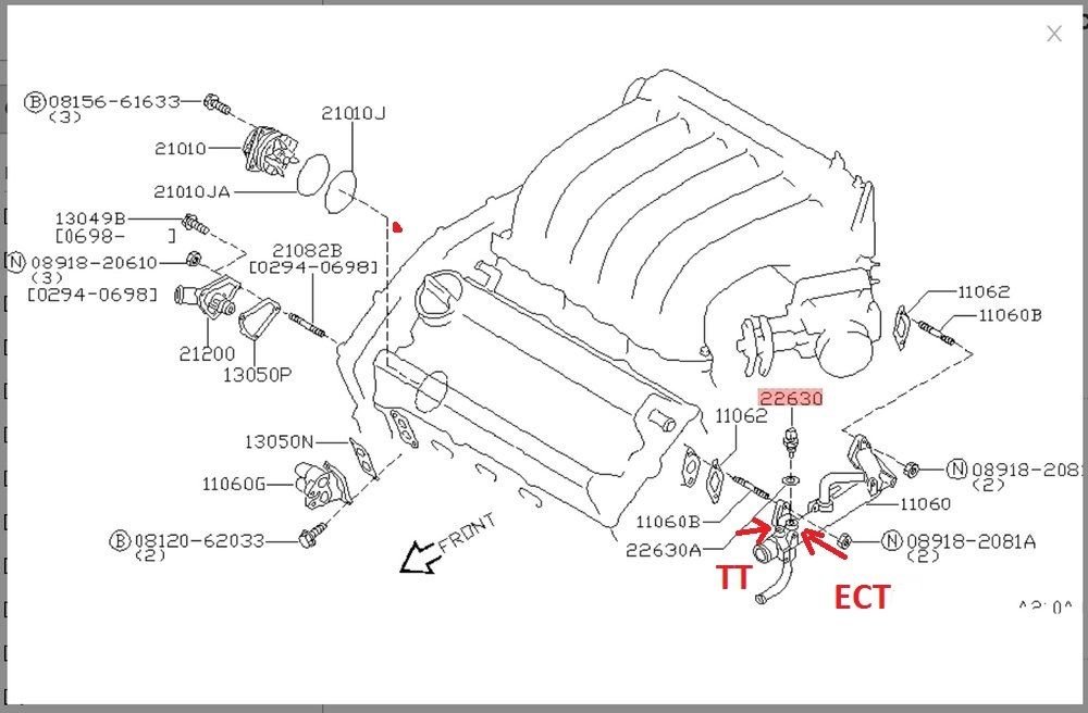

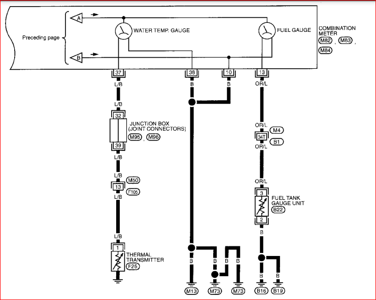

Thermal Transmitter is the one which sends water temperature to cluster. This sensor sits next to ECTS on return coolant block line. ECTS is the one closer to firewall side, TT, closer to radiator side. Page EL-83 (97FMS) shows test for bad transmitter or loose ground in cluster.

Quote: Thermal Transmitter is the one which sends water temperature to cluster. This sensor sits next to ECTS on return coolant block line. ECTS is the one closer to firewall side, TT, closer to radiator side. Page EL-83 (97FMS) shows test for bad transmitter or loose ground in cluster.
The part highlighted here is the ECT sensor.
Where is the Thermal Transmitter you’re talking about?
Virtually next to ECT like loving couple sitting in a park , TT is on the radiator side.

I'm sure it's your gage not the thermal transmitter (Thermo Bulb)
