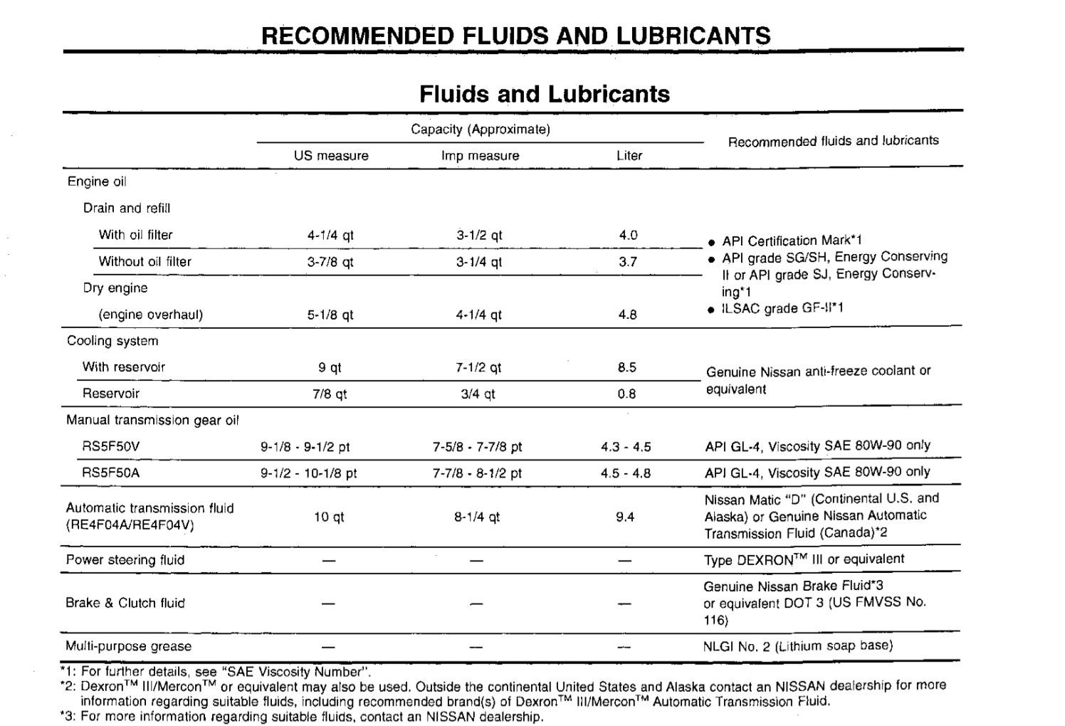

greetings i recently boght an maxima 99 and as part of a yearly maintenance schedule i plan to change trans fluid, a friend of mine, nissan enthisiast told me that i have to use oem dealer- bought transmission fluid, if i use anything else i will kill the trans, in my town there is no nissan dealer so its a little hard to get i, what do you think?what do you guys use?

I think you buddy is wrong. Your Owners Manual or the Factory Service Manual should guide you as to what you can safely use.

I use Wolfhead Super universal Fluid In mine..320K later and Ive never had a Single issue. Ive used this in several thousand vehichles actually over the years. Nothing beats the OEM fluid however. Order it online or visit your local store for its equivalent.

Here’s what your Owners Manual and the FSM say ...
Pay close attention to foot-note 2.
