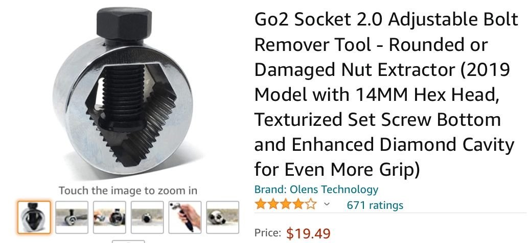

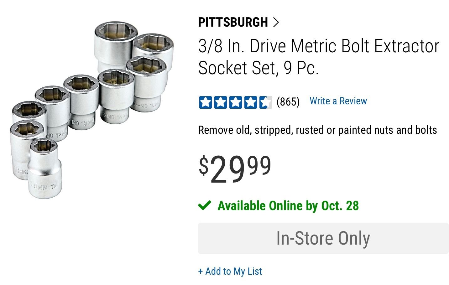

Doesn’t have to be these brands.
Doesn’t have to be these sets.
Just pointing out that tools are available to address this very need.
They are likely even available for loan-out or rent at your local parts store.
tools are supreme to the job!!
and almost always,. If you like the tool keep it for future jobs. If you don’t have a use for it later, pass it on.
id go with the offset wrench then sockets

yeah, it has yet to round the corners yet, but I can feel it starting too. I bought a cheap 12mm wrench with a completely closed end that I’m just gonna file down to fit correctly.
