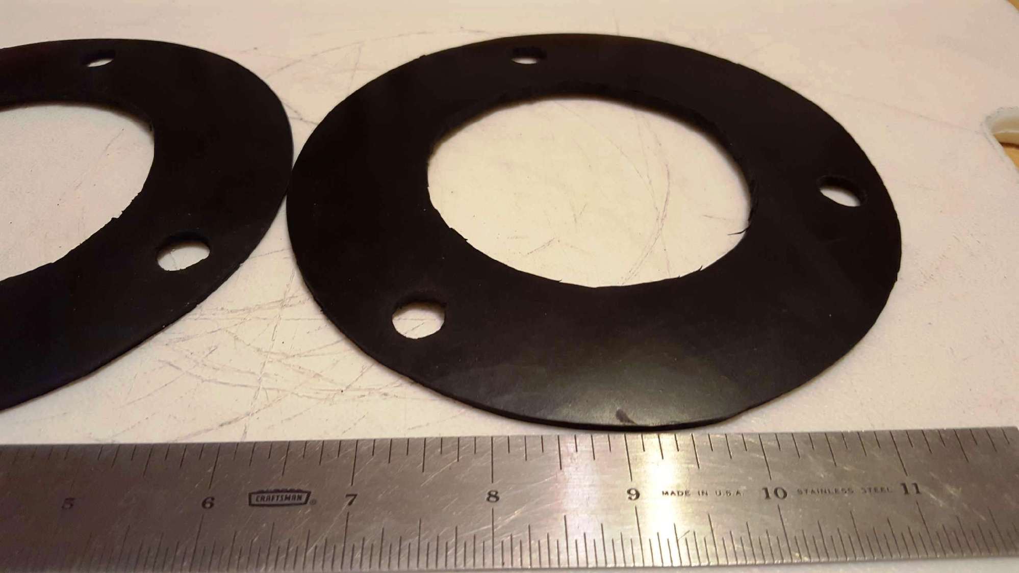

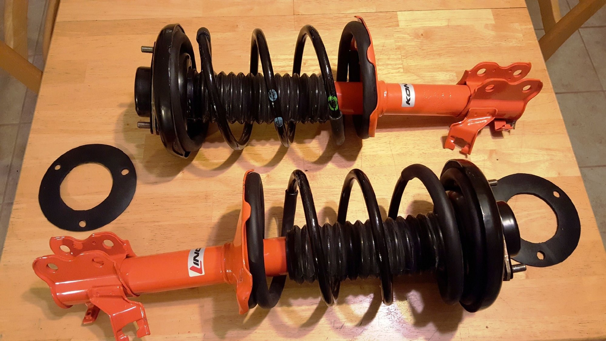

Hopefully Koni steps up. Bob, the STR-T Product Manager is a good guy if you get a chance to speak with him. Me and another forum member here used thick walled heat shrink tubing on the springs ends for insulators. Now I would never do them without
We also made gaskets for between the strut and car tower with 1/8" hard rubber matting to quiet the ride even more. It was intensive but well worth it going a little overboard. Crappy Roads and minimal noise over them is nice.

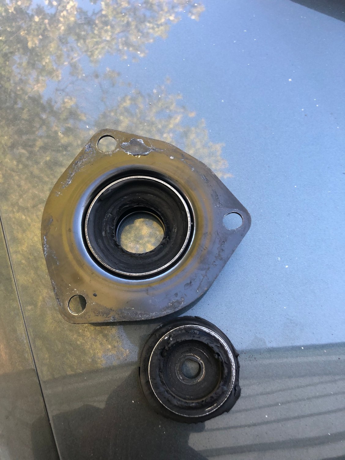

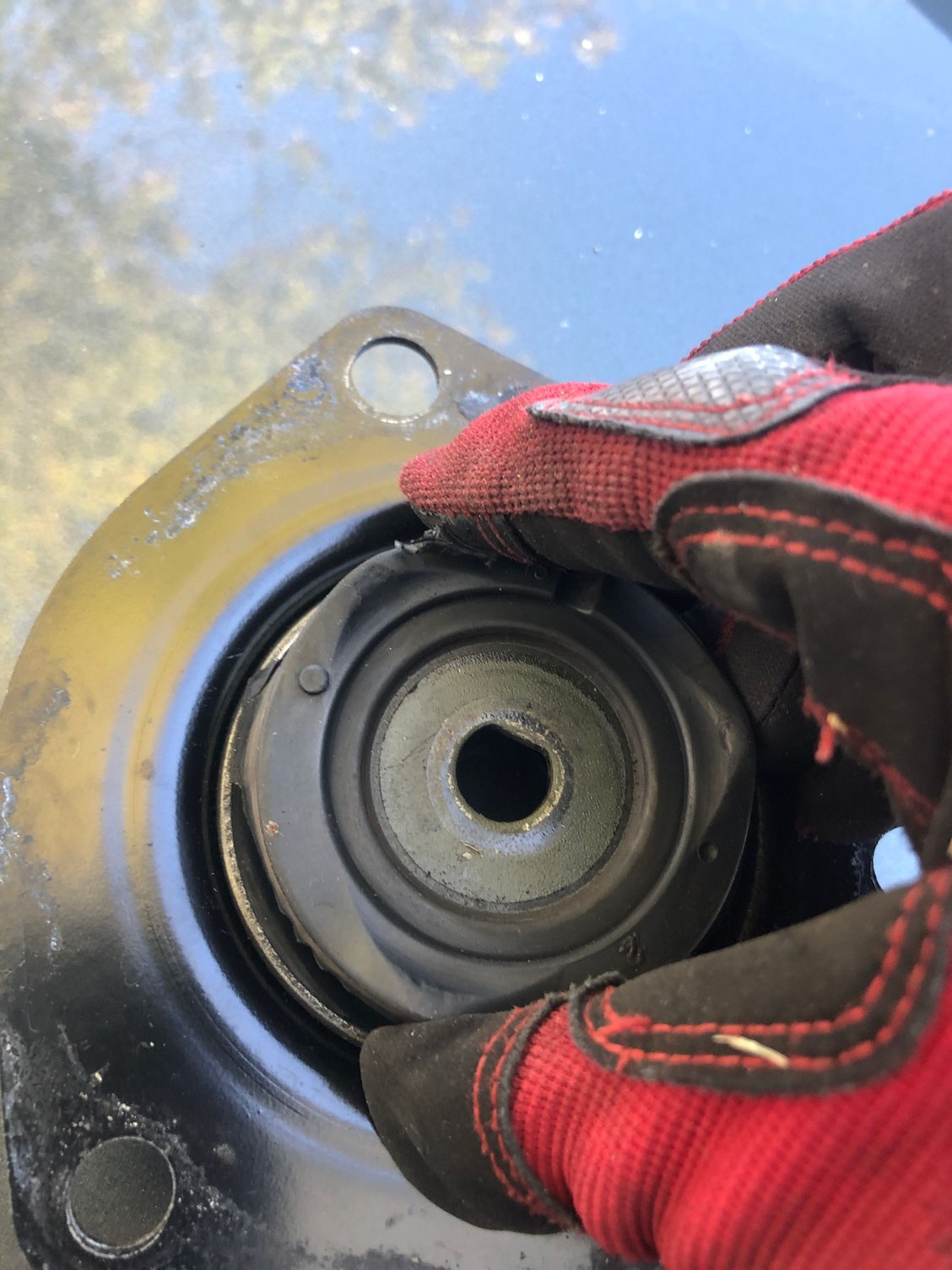

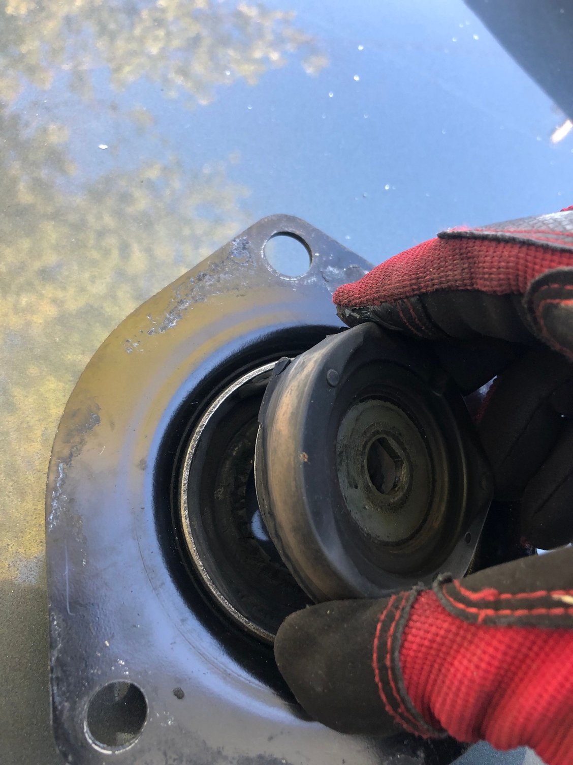

The Koni warranty strut came I have everything installed.
On closer examination of the old failed parts, pictured below, the KYB top strut mount failed, not the bearing. These pieces pictured below are supposed to be attached to each other, not two pieces
