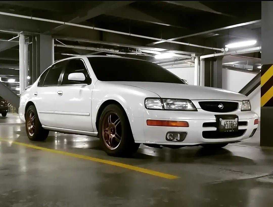

thank you in advance, still learning a bit on this 4th gens. Pic for fun

Also very nice looking Maxima good job taking care of it

And thanks i try to keep it clean since 39k on the clock exactly today lol
