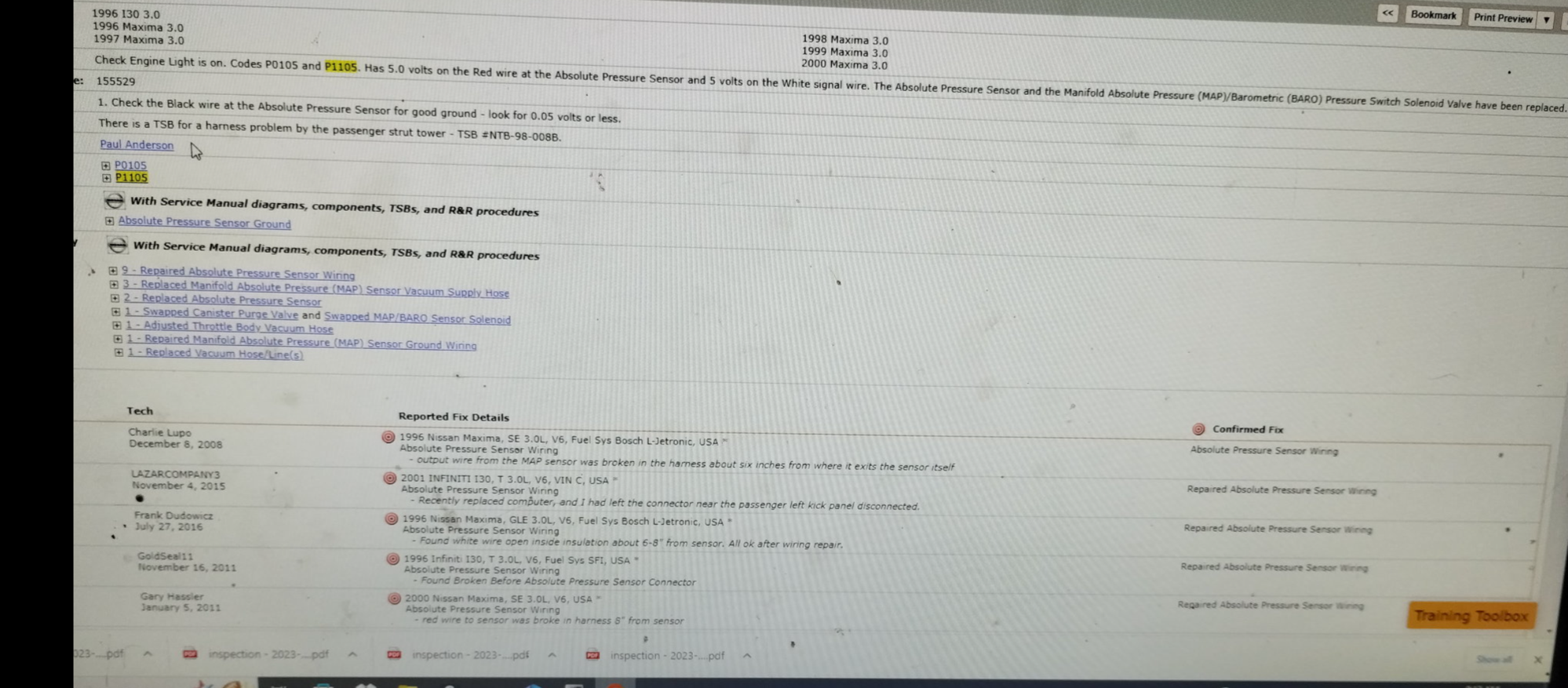

Been having the 1105 for some time now...
I'll clear code and it'll pop back up after a few hours...
Things I've done...
  • Tested Map sensor and amperage/volts
  • Tested Map sensor connector/plug for amps/volts
  • Replaced Baro switch solenoid and tested it for amps/volts
  • Tested Baro switch solenoid connector/plug for amps/volts
  • Replaced vaccum lines for Map sensor and Baro switch solenoid
All of these tests passed...
I'm stumped...
Does anyone have any ideas on what else I can do please?

Im having the same exact problem.
