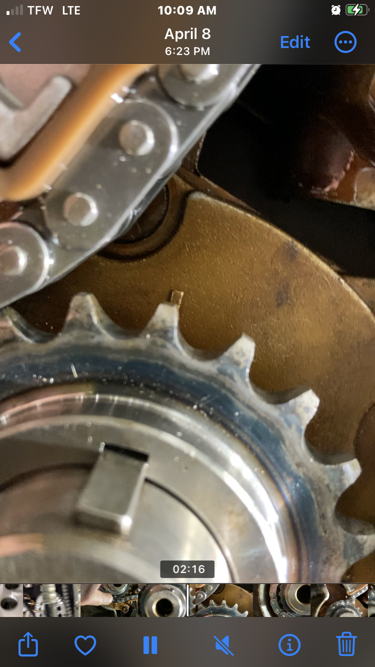

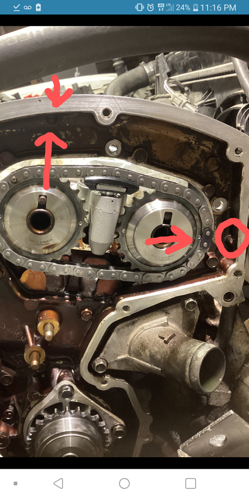

Front head I believe is on time. (Picture one) and I removed the old chain sprockets and cam unspun at this spot. Which coincidentally was the correct time.
Picture one: front head sprockets

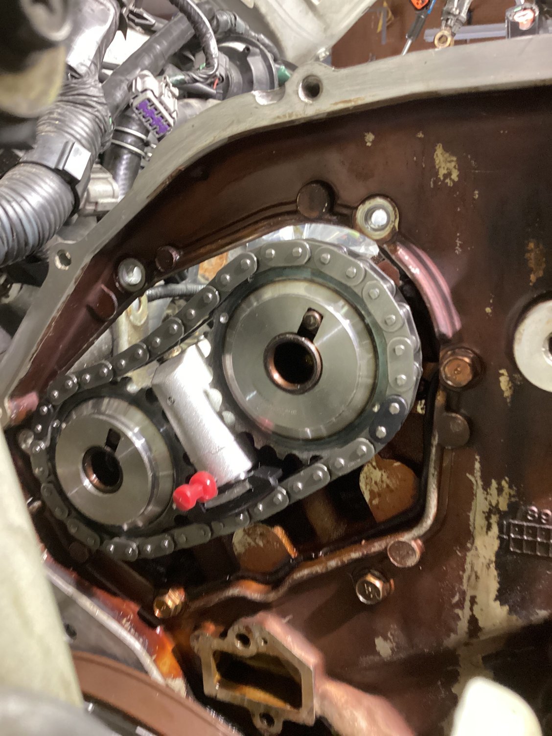

Picture two: rear head sprockets

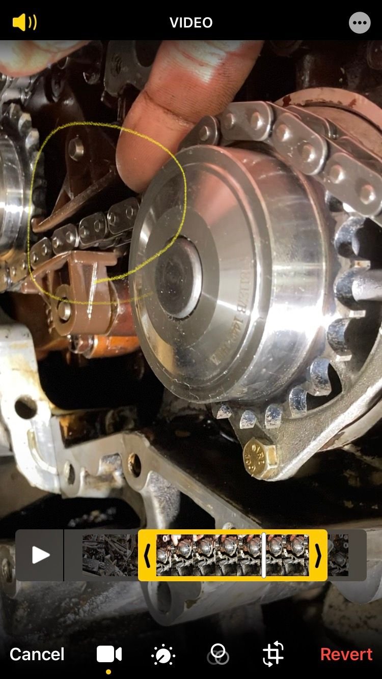

Rear head (picture two) chain markings lineup with the sprocket markings, however, the notch is not up, nor are those markings lined up with the markings on the back timing cover. I have attempted to rotate but I’m having a hard time, keeping it in place while installing the sprocket and chain.

Rotate the crankshaft so that all pistons are center in the Bore. You can then turn the camshafts, any of them for that matter to get them aligned with their marks. Once you have done that, rotate the engine back to TDC #1 and install the main chain and guides.
The rear cams are just out of alignment.. On the inside of the camshafts their is a hex for a 24mm or 27mm mm wrench you can use to turn them.. They need to go up/counter clock wise to the nipple on the inside of the cover, just as they are in your top picture (#1) of the front head.

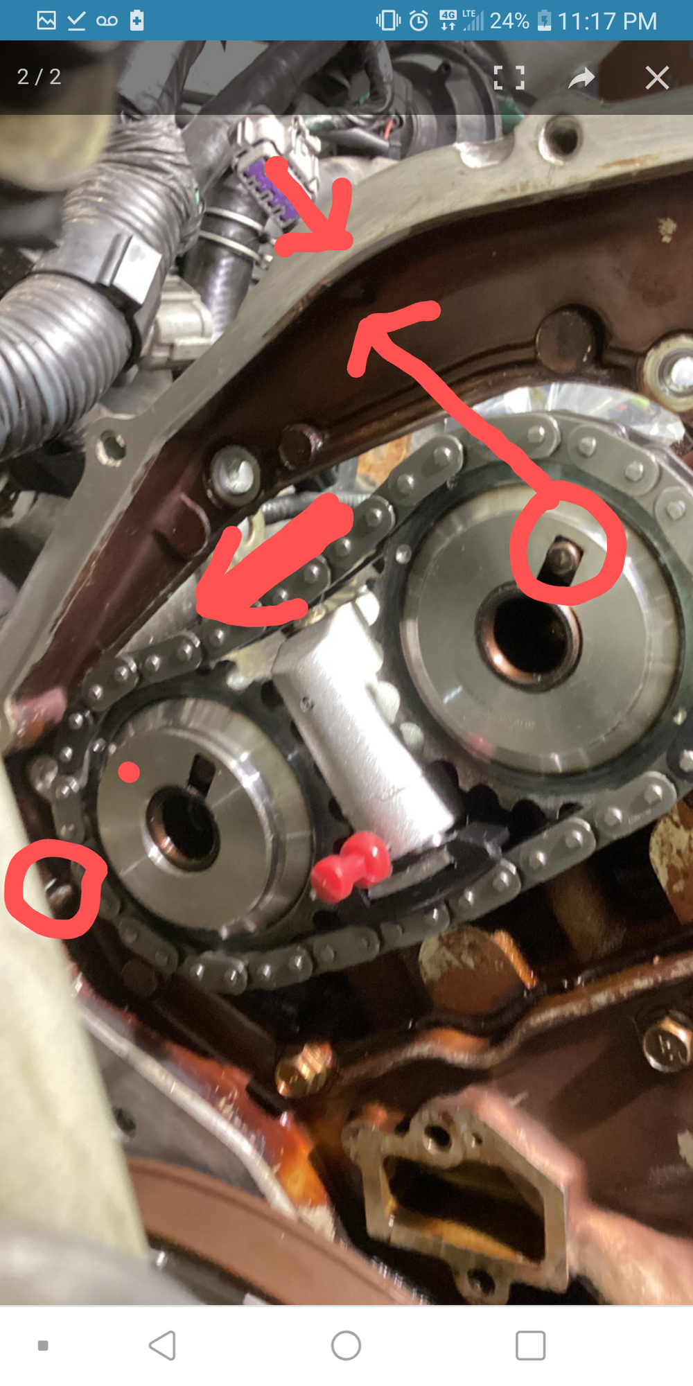

The B2 head (Radiator) side is correct pic 1
B1 (Firewall) needs to rotate up Counter clockwise pic 2
Rotate crank off tdc #1. You can turn it either way about 30 degrees so that the valves have clearance when opening and not hit the piston. You can them safely rotate the cams COUNTER clockwise to match those marks inside the cover I circled.. You can leave everything in place and rotate them just as the are. It Should just be one lobe back to line it up.

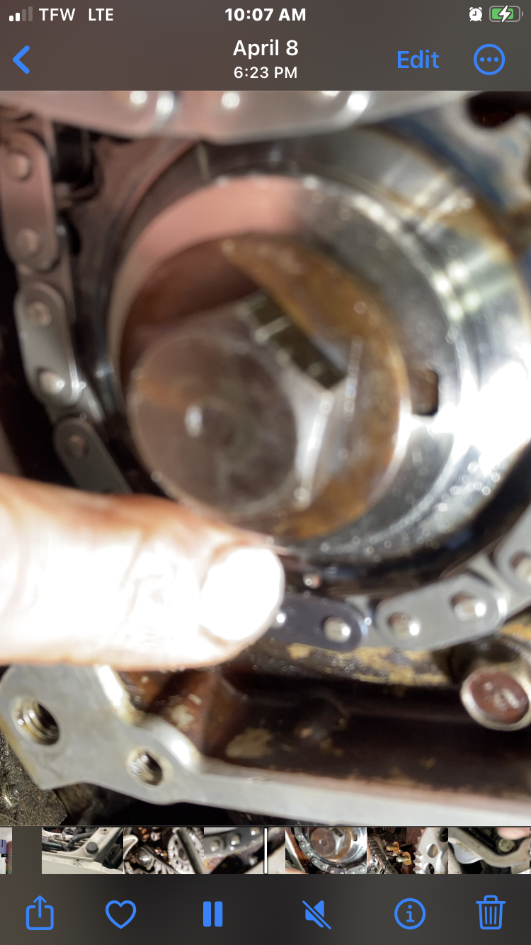

“ just about died” later turned into it died. after a test drive. Didn’t even get to a 10th of a mile. Didn’t start after it died for about five minutes.

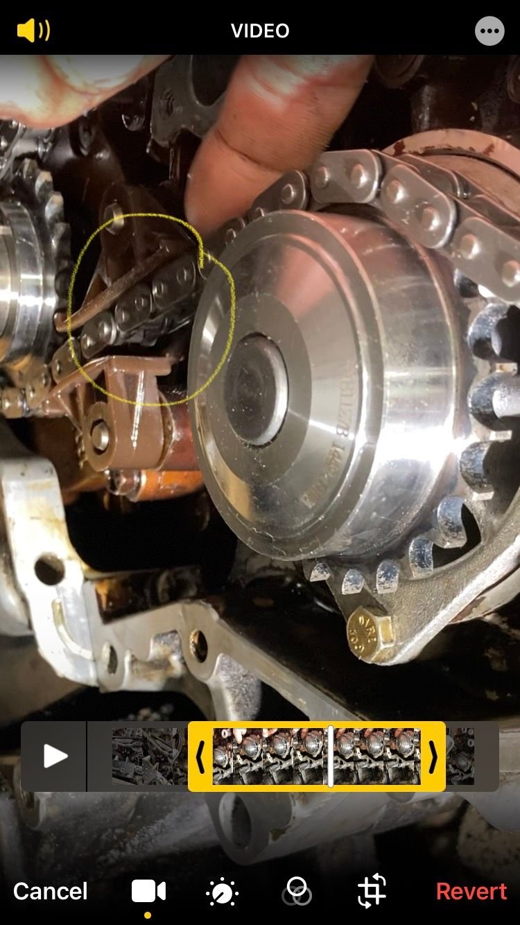

As far as I know as an amateur mechanic, it was in time. When I install the chain after the cams were in place, as you had shown, there was slack on the water pump side of the crankshaft at top dead center. Yes, I did rotate the cam shaft not even 20° to pull the slack out to the tensioner. i’m pretty confident that it was in time. However, I can be wrong..
Nothing sounded as if it was knocking. It just jerked and sputtered.
As far as the pressure goes for oil and fuel I’m completely ignorant.

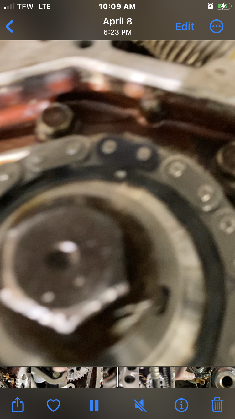

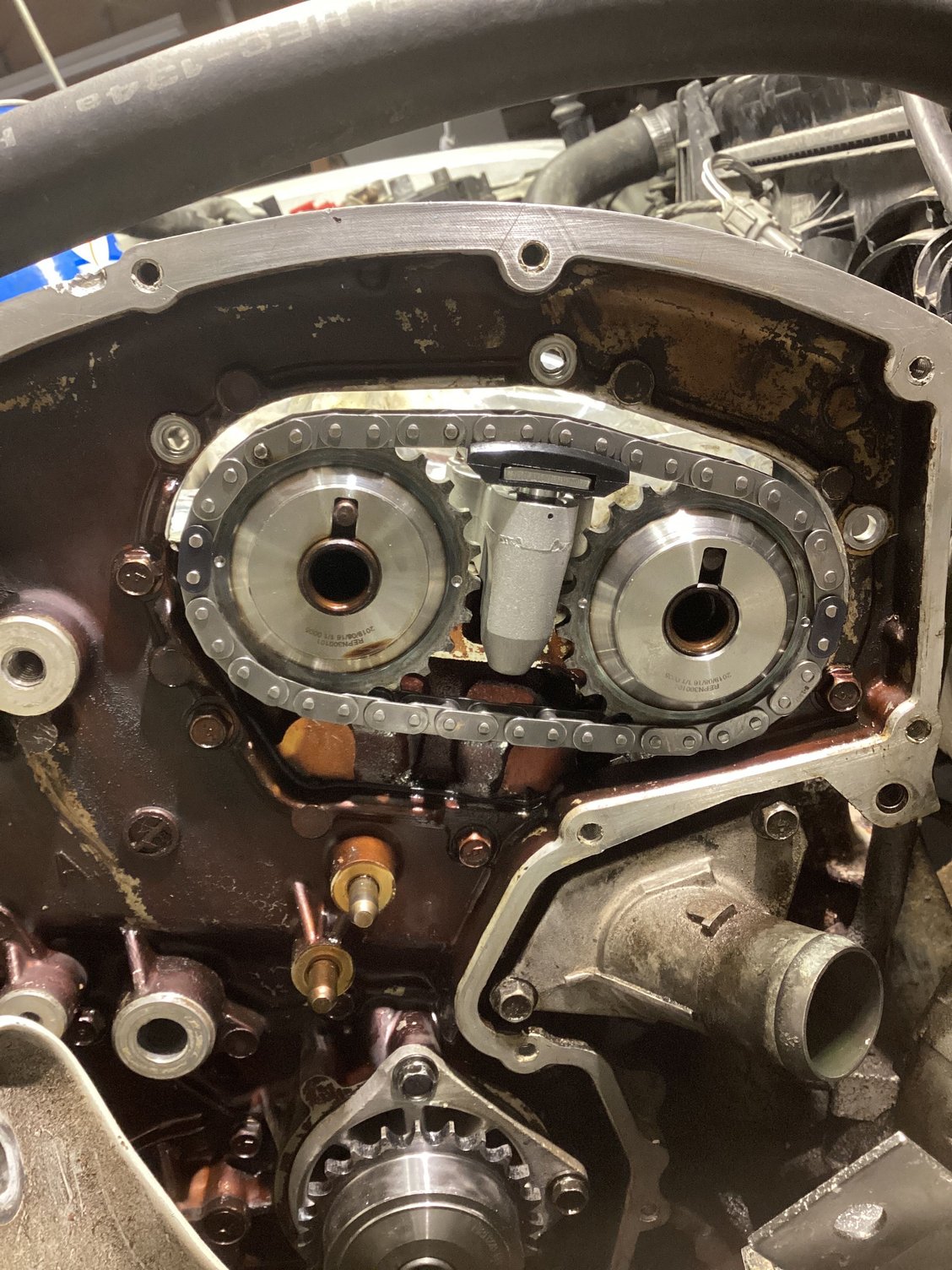

here are some pictures of the alignment, maybe blurry however, you can still see the arrow on the sprocket, mark on a chain, and then the tit on each.
Slack that was pulled out to the tensioner

Was the slack their Prior to you ever starting the car if so you were already off. There should be zero slack on the front side of the chain.
I have had not so good timing kits where the chain is off or not assembled correctly. Part inspection is critical. Compare it to the oem chain to be sure it does not have an extra link if its not oem Nissan.
The tensioner could have also failed and caused it to jump to. I have had that happen.
What you need to do here is remove the timing tensioner, realign everything. You do not need to remove the intake or valve covers. The cams will stay locked together by the rear chain. Turning them by the cam bolts is fine.
Besides the tensioner you really don't need to remove anything else. Just put it back in time. I would Slack the crank chain completely off the crank shaft and move the slack to the rear. so that its tight. It looks like it's 1-2 teeth off..
The trick to this is to install the crank bolt with a spacer of some kind and use it to turn the crank in place so that the chain is tight and the marks line up. The chain is new so honestly just line things back up.
Imo, if the slack was not there before then the tensioner failed. Buy a new tensioner anyway so that you don't have to do this again. Keep us Updated..
