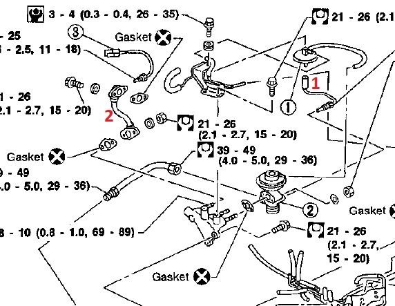

To be more specific, the EGR "System" is problematic. I'd say the EGR valve itself is pretty robust and not likely to need replacing.
Two of the most common issues (highlighted with red 1 and 2 below):
1) dried and broken rubber hose (only about 1.5" long) between the EGR valve and the BPT (Back Pressure Transducer). When this hose breaks, it's impossible for the EGR valve to open and you'll get the LOW flow code (0401).
2) partially or completely clogged manifold-to-egr tube. This is not an "IF," but "WHEN" scenario, and if you have over 100K miles and it's never been cleaned, then for sure, it's clogged to some degree. This prevents the exhaust gas from actually being drawn in to the intake manifold and therefore the temperature sensor (no. 3 in drawing below) will likely report a low value to the computer when it's supposed to be measuring hot exhaust and again trigger the low flow code.
Cleaning out the manifold tube (red #2 above) properly requires it to be removed completely. This is an egregious task to say the least and plenty of info on here about some of the tricks for getting it off.
