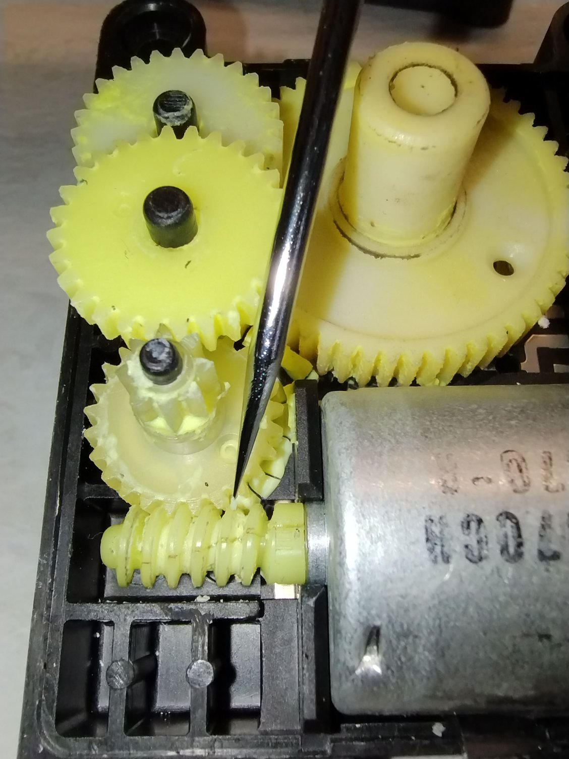

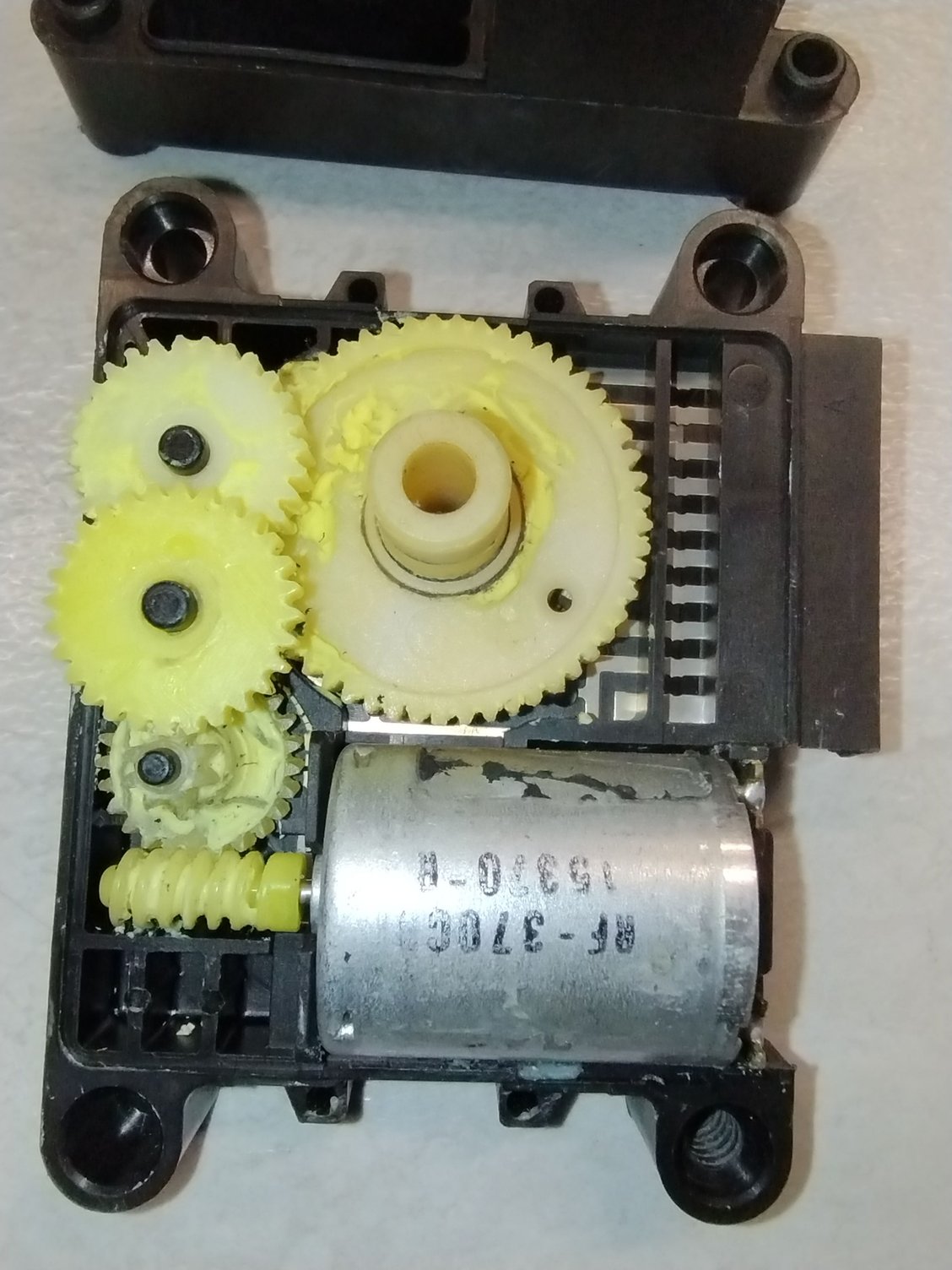

I did read in an earlier post that your ac blend door actuator does not work, If you have digital climate control, it also means you have a 10 pin blend door motor, which is not the one listed for your car. I had to buy one from an infniti j30 to fix mine in my 95 max with digital climate as it's failure to move causes the blower to only blow half speed when its not in the correct position.
I've found that in time the worm gear inside the blend door motor cracks and allows the tiny motor to free spin but not actually turn anything. I ran into this so I temp fix mine it until i could find another.. in the end I now have three. Take yours apart and see, if yours is in fact this one and you need it, lmk ill send you one of these, Keep us Posted
