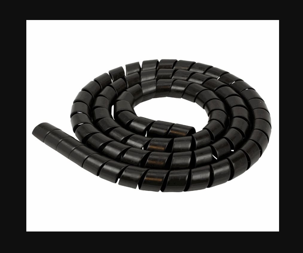

Elaborate a little, if you will, on the heat-shrink coil insulators.
Mostly, brand and where to purchase.
I’ve been running the wrap-around coily stuff and I’m not sure I’m happy with it.
Gotta get started on a front suspension re-do pretty soon anyway, so I figure …
