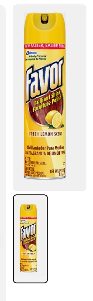

As far as your clear coat issue goes … I use this stuff frequently and routinely:
If you’re interested in this stuff’s use, PM me and I’d be happy to explain my process and my results.
