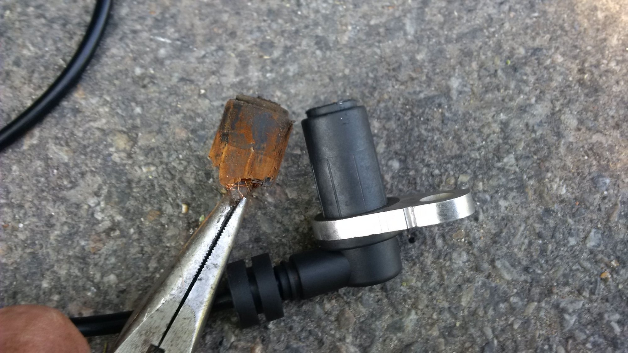

just had this on my 2001 i30
did the ground the pins thing and it said front left sensor
I went to take it out, the bolt holding it in place snapped, then i could not remove the sensor, had to break it apart piece by piece the rust was so bad it fused the sensor to the metal
Took me a few hours to get it out. Replacement sensors were pricy, i found one on clearance for like 15$ for a 2003 maxima, everywhere i looked it said it's not compatible with a 2001 i30
Long story short it is compatible the connection is the same and the sensor itself is the same, only difference i saw was the rubber was a little different and the wire was slightly longer, i secured it with zipties to be sure
plug the battery back in, start the car, no more lights! ABS is back. since the bolt snapped i figured i have to at least RTV the new sensor in, but once you put the new one in, the thing is so snug in there there's no way it's coming out.
anyone having issues with a Q45 or J30 where the sensors are like 600$ i'm sure you could cut the wires and sauder a new sensor into place for much much less than buying a new one, i'm somewhat sure all Nissans of that era used the same 2 wire system
