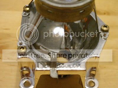

2 hot new HID projector retrofits
Since not everyone likes the look of the ebay projector headlights, i picked up some 00-01 headlights to fool araound with. these are not finished yet both still need some work, and unfortunatly i only have enough parts to make 1 of each, but now that i got them almost finished and they look good i will get my hands the parts needed to finsh these up.
hella rs6 bixenon
bosch golf/jetta d2s projectors w/ seperate H7 Hi beam reflector

I was also thinking of doing LED park/turn signals for these, but put them off to the side and maybee try and fit either bosh H3 foglight projectors,or a set optilux projectors in where the bulb sits, for acessory driving lights, but that might a little to much work b/c a potion of the lens would need to be sanded smooth.
the flat chrome part , (to right in 1st pic, down in second pic) that is on the side of car, is where the leds would go, od the auxilary prjector would sit in the depressin of the turn/park reflector
these are the projetors i was thinking of using
or

some indoor pics, from about 15 ft
the rs6 is a nice projector, it fukcing big, 3" dia. lens and nice color
low beam.............................................. ......................hi beam
the golf has a similar output to the E46's but has a strange little lever on the side of it so the cuttoff can be switched from ECE to straight
the golf pojectors lever - switched to flat cuttoff, moving it down gives the ece pattern

When i get these finished up i will post some better pics, they weren't very photogenic when i took those, the pics were either bleached by the reflected flash or grainy and blurry b/c of low light, then my batteries died and these got put to the side.
these are extra lights i picked up, to see what is involved for a oem 00-01 retro, b/c i have had quite a few members ask. the rs6's are about done they need a shroud to hide the reflection of the projector, its hard to see b/c the pics are crap but the copper wire of the bixenon solenoid is reflected below and to the right. I got the stuff to make a shroud so everything gets tucked away nice and clean, I am pretty sure the rs6 have a buyer but that not a definite as of yet.
the golf w/ h7 hi beam still needs more work to get everything to fit inside the housing and work properly. Function follows form when making these up......I knew what i wanted them to look like, got everything so it looked good then got to work making it fit and adjust correctly. its a PITA and an odd combo of parts i need to get my hands to complete the second one, so it may be while before they gets finished. When they are finished, probably going to be a one of a kind set. b/c the parts contributing to the come from headlights that are a bit scarce and they require a lot of work to put together. so the cost of making up more sets would be prohibitive. But the pic does not do it justice, it looks real sweet up close. i really like look of that 1 1/4 " lens swimming in all that chrome,would definatly get a second, third and forth look from someone who knows the maxima, those who don't would look right over em b/c they look OEM.
when they are finally done they are going need a good home but cost more than my other retro's,
