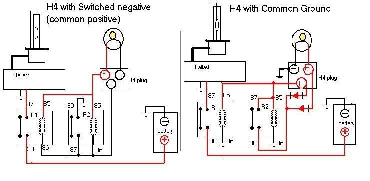

So I'm thinking of doing the retro for the projectors but i don't want to kill my hids when i flash my beams at some idiot so....... Would tapping the positive or negative of the high beam with the low beam let the low beams stay on? could this werk wit fogs too?

If you are going to do a retro, build a wire harness to power the ballasts, dont use stock headlight wiring, use the diagrams in the link below to construct your harness. it will allow you to only use high beams with flash to pass, but also allow the low beam to stay on when switched to high beams.

where does the stock wires connect to in the switch ground diagram?
i think once i know where your putting in the stock wires it would make a lot more sense to me
and so if you want the fogs to stay on then you would need 3 relays?
damn i'm so confused by the diagram

run a diode from the high beam to the low beam before the relays

alright, use this diagram, it has the relay terminals numbered and should make things a little simpler to wire up. on the ebay projector housings once you remove the old halogen projector you are going to have two wire inside the housing that used to power the H3 bulb:
Black wire = positive
white wite = negative
On the passenger side just get rid of them and save only the wires needed for high beam. on the drivers side, what i usualy do is pull the white wire through the rubber grommet and then run the black wire through the hole left by the white, wire. so there is now a positive and negative lead outside the housing (if that doesnt make sense it will w/ the lights open and front of you).
those two leads will be used to trigger the harness
black to terminal 85 on R1 & 85 on R2
white to terminal 86 on R1 and 86/87 on R2
i use weather pack connectors on those leads, so the harness isnt directly hardwired to the drivers light, and can be disconnected easily

you dont need three relays for foglights to stay on as well, just do the foglight only mod and you should be all set
