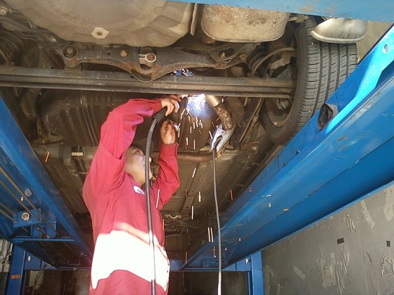

Old Apr 14, 2013 | 07:02 AM
Iron Maxima's Avatar
Joined: Apr 2013
From: DMV
Thanks for all the advice above, really saved a lot to wield scrap flex pipe in the buy a whole new exhaust!
Old Apr 14, 2013 | 09:02 AM
Joined: Apr 2013
From: DMV
Also thought I'd share if you're in or around Manassas, VA:
Master Care Auto Repair
9111 Industry Dr
Suite G
Manassas Park, VA 20111
(703) 393-1057
Its a small shop, has a lift, and does custom exhaust (I think that would be integral for anyone looking for a shop that can weld and easily fix this issue). I walked in on a Sunday, Obvidayo? fixed it right there, and for real cheap.
If you have the tools you could do it yourself.
