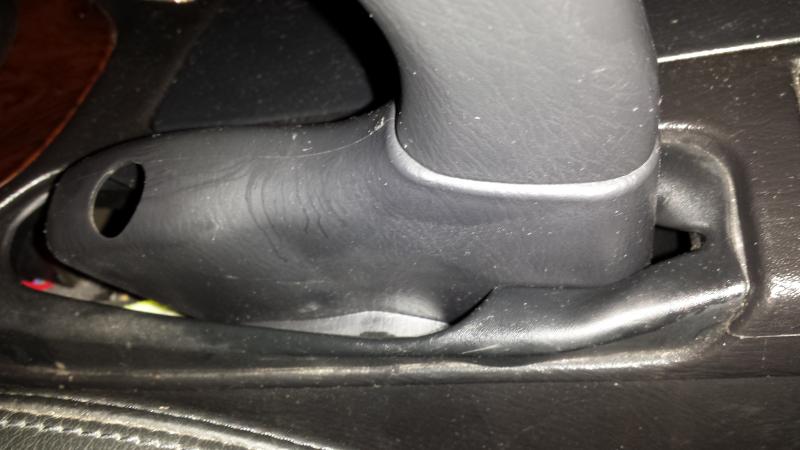

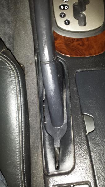

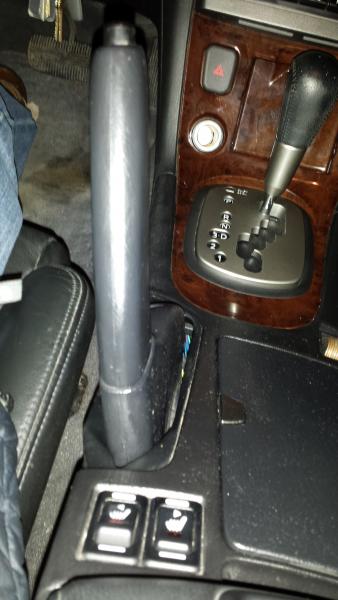

Hello everyone...I am a new (to me) 2003 Maxima GLE owner as of this afternoon!!
It is a 1 owner with 88,000 miles. I drove her home today from the place of purchase, which was about 45 minutes away. I noticed that at deceleration (40 down to 0) and acceleration (0 to aout 40) I have a grinding sound from what seems the front of the car. I am figuring it just needs brakes. Or maybe in need of new calipers as well. No steering wheel shaking or anything.
However...I did notice that is seems the parking brake is bent to the drivers side a bit. Not exactly sure if this is the design or the way it should be, But found it odd. I will take a picture, and post of possible.
The parking brake seems to engage as soon as I pull on it, and the light goes on. When I put it all the way down, the light goes off.
Is this sound just a signal that I need new brakes? Or is this something a bit more serious? Just trying to learn about these beautiful cars.
Thanks SOOOOO much for the help.

Here are some pictures of the parking brake.
I am going to post this question to a specific thread as well.
Thanks.
It sounds like the parking brake is not adjusted properly. The light should come on after one click is heard. The brakes should not engage until after maybe 10 clicks. At 10 clicks, you should need a force of 44 pounds to pull the lever.
See page 35 for parking brake adjusting:
http://boredmder.com/FSMs/Nissan/Maxima/2003/BR.pdf
If you want the complete service manual:
