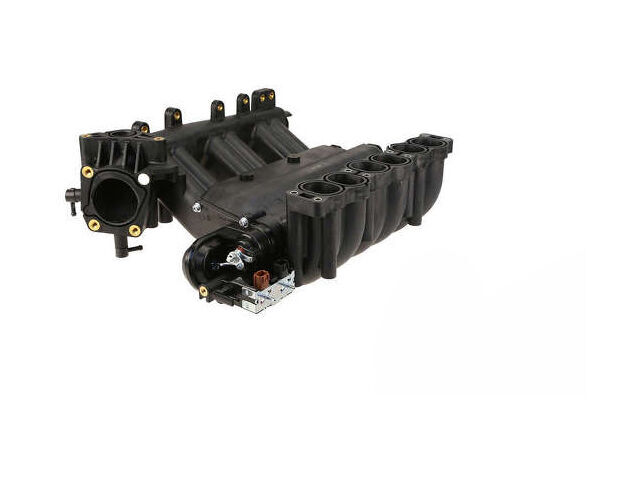

if only someone could have snapped an image of the part numbers... below one is on eb ay
I really suspect that part is no longer available new.
different offering on eb ay
It may not be considered a different part from the intake upper...
14013M - COLLECTOR-INTAKE MANIFOLD
14010-2Y910 Applies: FED.VQ30DE
04.1999 - 07.1999 01 Out of stock

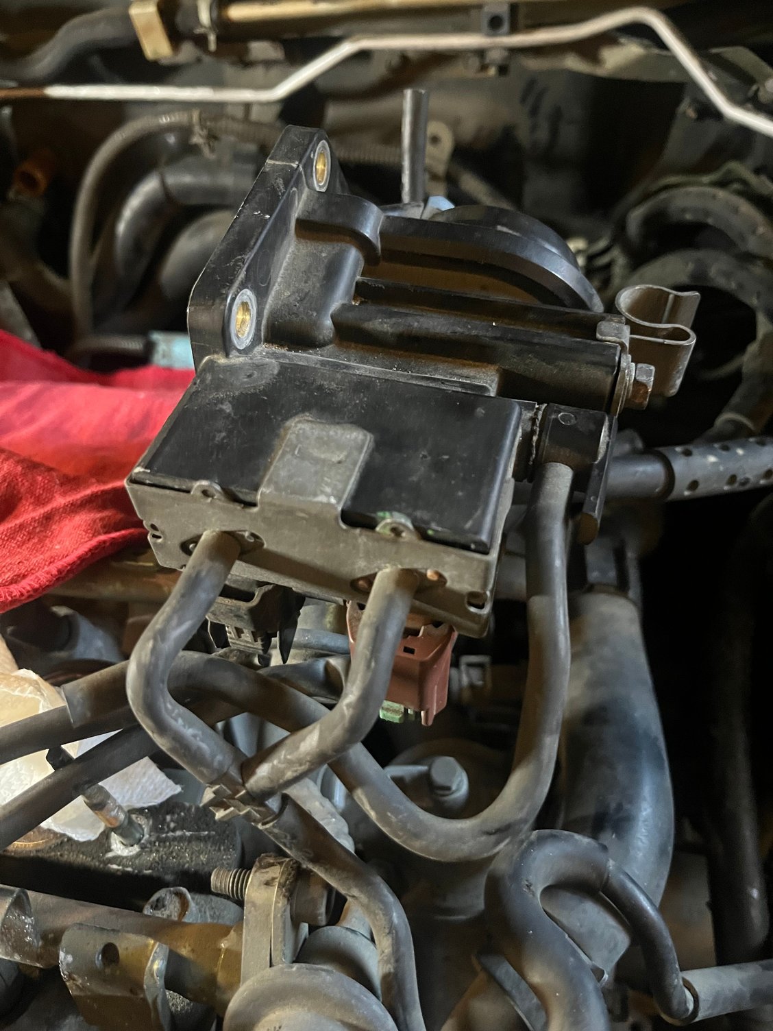

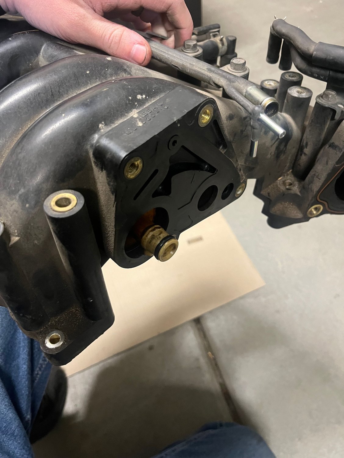

I have a 2001 Maxima that was engine swapped with a 2000 Maxima. I took off the rear valve cover yesterday, in doing so had to remove the upper intake manifold. To take the upper intake manifold off, I removed a part that I don’t quite know what it is & think I may have screwed myself a bit.
The piece while it was still attached to the upper intake manifold
Where the piece was connected. It had springs inside the white plastic piece that stuck out, they fell while I was taking the upper intake manifold off & I do not think I found all of them (I found 2, one large & one small)
Where the piece was connected. It had springs inside the white plastic piece that sticks out, they fell while I was taking the upper intake manifold off & I do not think I found all of them (I found 2, one large & one small)
Where the piece was, now with the intake manifold off
Another view of the piece with the intake manifold removed
I’m really hoping for some advice on what this is & how I can put it back together the right way. I was trying to find info on it all of yesterday since I lost the springs & just havent had any luck at all.
