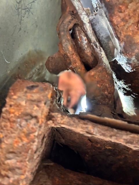

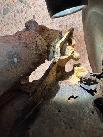

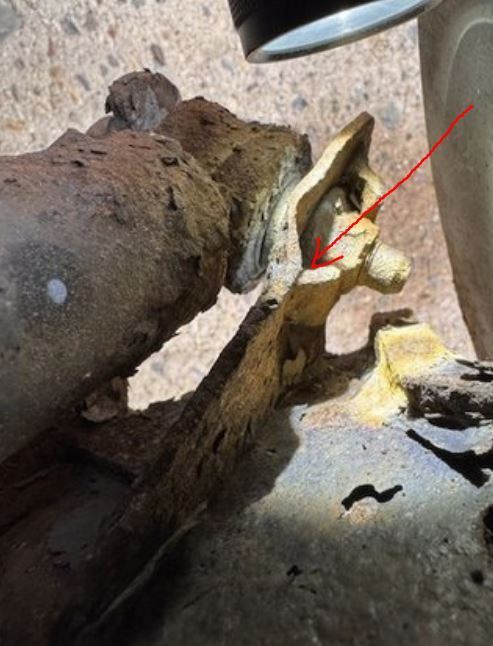

Yes I am trying to replace my rear strut assembly on my 2002 max. I was able to replace both front strut assembly last year without any problems. I saw a youtube where one guy used a vise grip but don't understand how he could possibly grip any surface area of the nut because there's a metal bar of the housing on the underside. Here's a picture of the top view and bottom view.

new car time with that much rust.
otherwise torch, welder, and pray

That's bad. Try heat or cut the bolt and get a new one.

Spray it well with PB blaster, hammer in a chisel in to the space to stop the nut from spinning, and use a impact driver to zip off the bolt.
