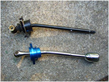

I received the STS from Cattma's group deal last week and installed it this weekend.
Removal/install instructions for:
Center console
http://www.vqpower.com/v2/readarticl...article_id=114
Shifter:
http://forums.maxima.org/showthread.php?t=25552
http://www.twmperformance.com/manual...stallation.pdf
From start to finish the install took took 1.5 hrs. There were no PITA steps if one has a flexible head socket wrench or universal joint sockets, AND one follows where to move the shifter to access the two nuts and one bolt to remove the old shifter and install the new one.
While the Ralco came with a solid **** see - https://maxima.org/forums/showpost.p...4&postcount=24, I chose to use my stock leather ****.
First impressions: Since I have never had any other exposure to other STS' except for a coworkers hurst in his camaro, and that today was really the first day I had any extended use of the shifter (thanks to DC traffic), there are a couple of noticable changes from stock.
There is an extended, but comfortable reach for the **** even up to 5th gear, and that the shifting is a bit harder. Since the bushings are new, this is one of two suspects. The other being by design where having lower leverage from the **** to the shift control rod.
Unfortunatly I was not able to measure the stock shifter (but have pics), the Ralco with stock leather **** sits 5.25 inches from the console and the actual throw travel is an average of 2.5 inches.
Attached Thumbnails Ralco Short Throw Shifter installed-stock-v-ralco.jpg   Ralco Short Throw Shifter installed-knobs.jpg
