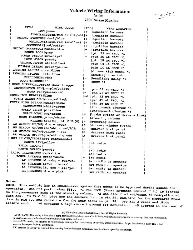

Iv read many wiring diagrams. But honestly they do not help. Cant someone just draw a arrow to the two wires??

which way is up and down on the first pic, i cant tell what im really looking at. It would be easier if you just un plugged the harness plug from the lock cylinder and take a pic of that.

actually you arent looking at the right wires at all, its this big white plug on the driver side of the steering column, right above the tilt lever. That is the harness you need to tap into. hope this helps

thanks. i disconnected that huge white connector and found the two wires i need
(red/black, and black/blue) but still nothing, The relay clicks, but engine doesn't crank. i don't know hwat could be wrong. i appreciate the help chopstix2nrz

Did you try with the key in the ignition? Our cars have an immobilizer that wont start the car without the key in the ignition.
You might need to turn to Acc position and then push your fancy button?
